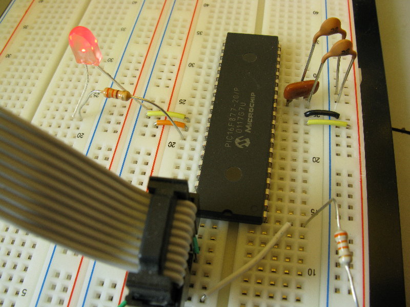

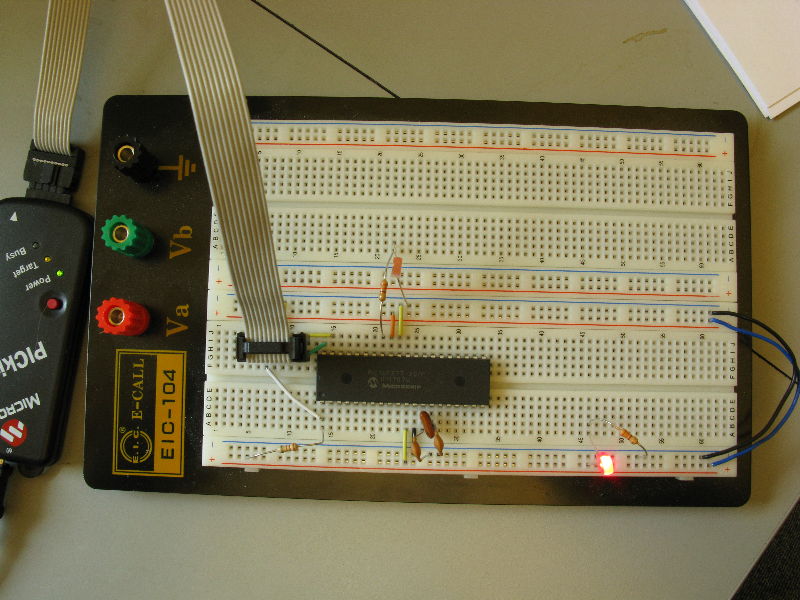

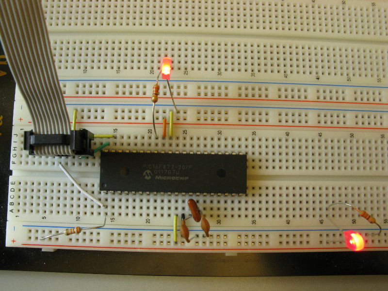

I just breadboarded up an 877 with 4MHz clock and wrote a quicky RB0 (Pin 33) blinky program for it. Program your chip with this hex file and see if it blinks. If it does, the problem is with your program. If it doesn't, the problem is with your wiring or chip or oscillator.
View attachment blinky.zip
Here are a few pics of the circuit. It's powered by the PICkit2.
Hehehe :D And even a 4.39MB AVI movie of it.
