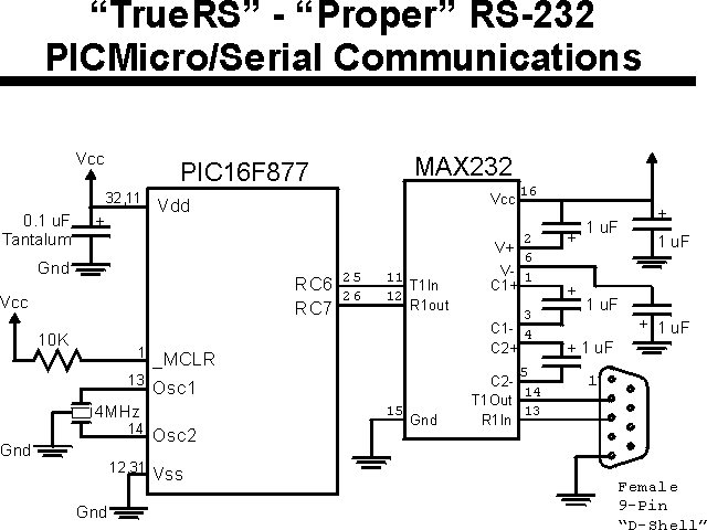

hi...
please give me the schematic diagram of PIC16F877+Max232+DB9 using the TX and RX...please....thankssss
please give me the schematic diagram of tws-371-3+pt2262+PIC16F877+Max232+DB9 using the TX and RX...please....thankssss
