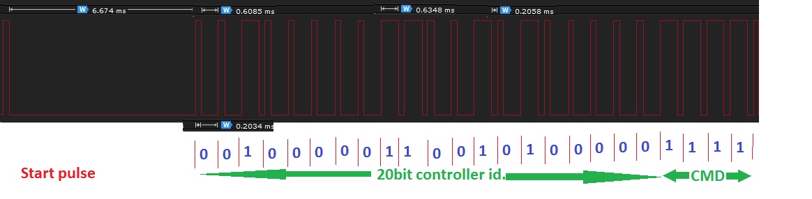

I have a requirement where i need to read the specific pattern of pulse.
Please refer the attached screenshot contains the specific pattern of data s inform Pulse.
