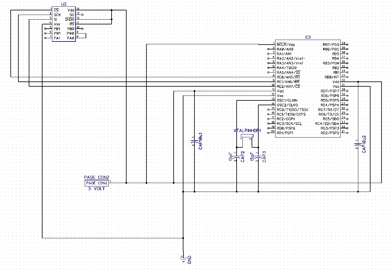

Hi there,
I wanted to control a digital potentiometer - Microchips MCP42100. It requires the sending of two bytes serially (via an SPI Interface) from the PIC. The first byte is a command byte and controls which potentiometer (there are two in the package) to write to and the second byte is a number between 0 and 256 indicating the wiper position from 0 to 100k ohms.
One of the application notes details exactly how to interface to these ICs so I pretty much copied the code (all I changed was the ports being used). It looked pretty easy...
Basically it doesnt work and I have no idea why... below is the schematic for the way its wired up to the PIC... simple connection to the PIC PORTE 0 -> /CS, 1 -> SCK and 2 -> SO.
Again the code has been copied from AN746 "Interfacing Microchip's MCP41XXX/42XXX Digital Potentiometers to a PICmicro Microcontroller". The Application Note (attached also) is really just one page and then source code... I used Appendix D for my code and it really only consists of two key routines and some delay routines.... my code is below..
Hoping someone might find an obvious mistake... right now the potentiometer reads 0.1k and if I check between the two terminals I get 187k... not 100k as I would have expected... I should get 40k ohms with the wiper position set to D'100'.

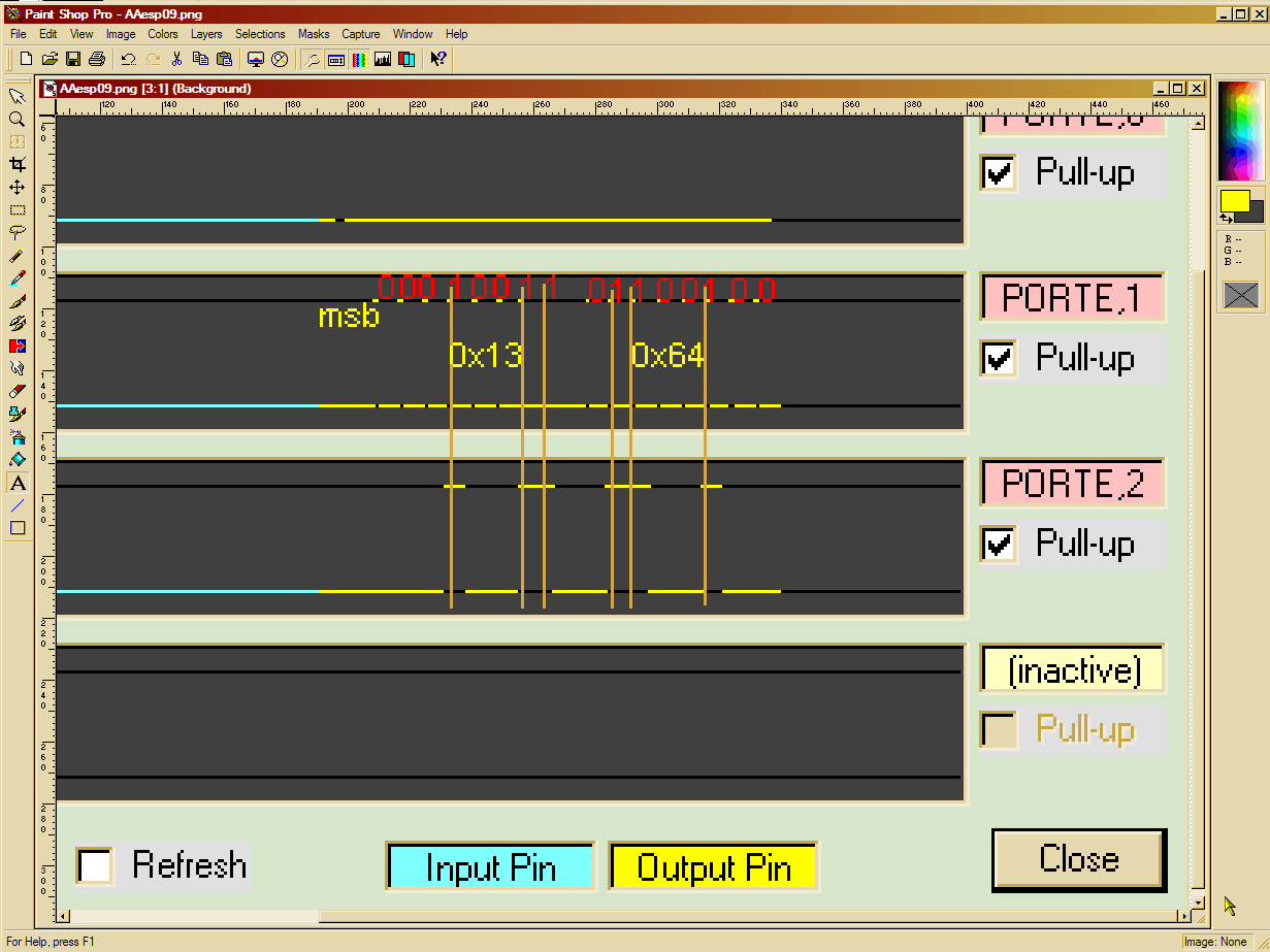

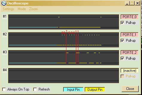

hi Simon,
Look at this Oshonsoft Scope plot.
It looks as though you have the clock bits out of sync with the data.;
LOAD THE COMMAND BYTE IN THE ACCUMULATOR B '00010011'

Firstly, thanks Eric for taking the time to have a look at this. I made the changes to the code... I understand the error I made now... however I am getting some really erroneous results with the chip. I have run the program twice first with D'100' as the wiper position between 0 and 256 and then with D'200'...
Here are the results measured using a multimeter...
D'100' D'200'​
PA0 - PW 27.3K 17.5K
PB0 - PW 39.2K 45.0K
PA0 - PB0 66.7K 64.1K
D'100' D'200'​
PA1 - PW 27.4K 17.4K
PB1 - PW 38.4K 44.4K
PA1 - PB1 65.9K 63.8K
So from this I think the program worked... as I get the same values on both pots.. however I must be missing something as the resistances do not add up to 100k.... really just 2/3rds of 100k.
I also replaced the chip that I used first with another (I have four of these) and got pretty much identical results... so confused...
Is this a chip where I have to ground every unused pin including all the unused PA PB PW etc ...
Simon

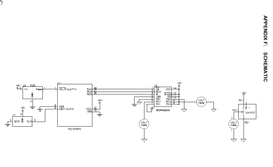

hi Simon,
How are you measuring the resistance across the 'ends' of the pots.?
Also have you tried wiring as per the Appendix F, in the datasheet, using their voltage method
Hi Eric
I didnt find an appendix F but section 2.1 Parmetric tests have a number of test circuits... I tried the setup as per Figure 2-25 "Potentiometer Divider Non Linearity Error Test Circuit". I had 100 set in the program. so using V*100/256 =2.00volts. which is exactly what I got when I measured the voltage... so it works... I am confused though...
So Why cant I simply measure the ends and the resistance between the wiper? Why was I getting incorrect values (as measured)... can I trust this to work in a variable gain op amp circuit??
Hi Eric
Is the pot connected to the circuit when you are measuring its resistance.??
If yes, then you are measuring the parallel resistance of the pot and its connected components.?
Look at this image from App F.
Hi Eric,
Thats the set up I used and it worked... Its when I measure between PA and PB and then between PA and PW or PB and PW... shouldnt it come to 100k between PA and PB and "x" and '100k-x" between the wiper and the ends?
Hi Eric,
With the pot connected as shown in that image, what voltage do you get on the wiper, when you program the pot for: 0k, 25K, 50K,75K and 100K when using a 5V source voltage..?
Hi Eric,
Right... did that. Here are the results:
0k 0 D'1' 0.02
25k 1.25v D'64' 1.26v
50k 2.50v D'128' 2.52v
75k 3.75v D'192' 3.79v
100k 5.00v D'255' 5.05v
The regulated voltage to the chip (and the micro) is 5.07volts..
So it works perfectly...
I was just wondering why I cant just check the ends and get the correct resistance with a multimeter? In this case 100k between PA and PB...
By the way thanks for taking the time on this...

hi Simon,
As its basically a semiconductor switching the resistive elements within the IC, using a meter on ohms [that uses an internal battery] you could get misleading resistance readings.
Are you planning to use the 'pot' as the feedback resistor in a OPA.?
Hi Eric..
Yes I was going to... I was going to make a variable gain amplifier with two stages and then program the pots to make it as linear as possible.
