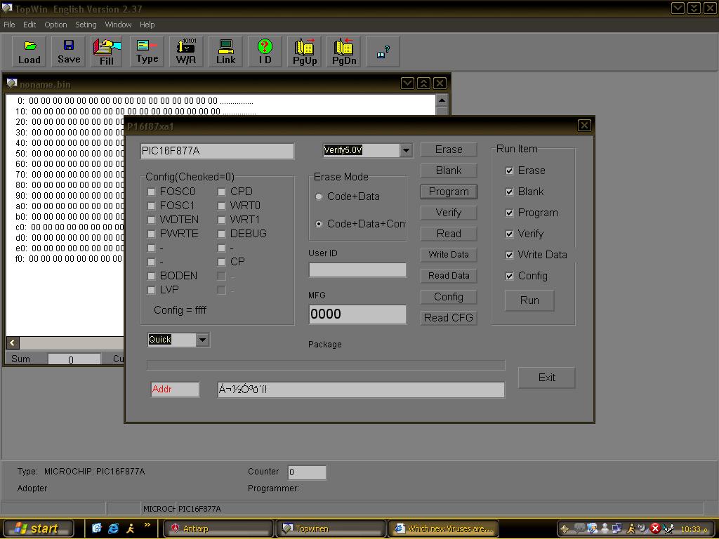

Hi im newbie to PICs comming from an 8051 family , i tried to program an led blinking program using mikroC, i connected the circuit as 13,14 as 11Mhz crystal , 12 GND,11 VCC . the output of portd is always 0, nothing happens i still dont know why ?

i suspect of the programmer , i posted its options , should i check any box there ?

OK, now you need to place a pullup resistor on pin 1, say 1k to 20k. This is the reset pin and leaving it floating leads to any number of problems.
Also, which pin did you put the LED on, how large a resistor are you using for current limiting on the LED, did you check the LED's polarity, and is the '877A getting a proper 5V? I ask about the pin because pin 6, RA4, is open drain as an output, so needs a pullup resistor (1K-10K) to get a high. BTW, it's a good thing to provide a bypass cap, say 0.1microFarad, between pins 11 and 12.

thanks , i tied pin 1 to VCC also it doesnt work !! , i wonder really where's the problem :(
are the two caps for the crystal 104 ??
