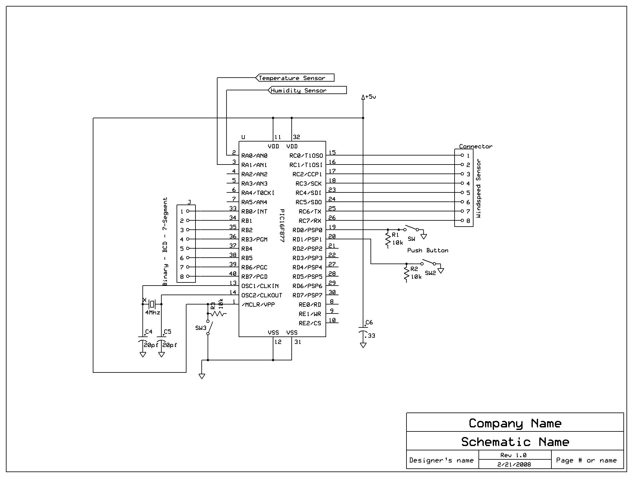

Hello all,
I in a senior design class and I am trying to program a PIC16F877A to be used as a weather analyzer. It needs to take input from a temp sensor lm35, a humidity sensor, a wind speed sensor, and out put temperature, heat index and wind chill. i have a program for a2d conversion, and I have some experience, but I am getting overwhelmed with how much i have to do, so i was wondering if anyone could help me out with some code. To output the wind chill or heat index i need to do some math, I don't know how to program equations. I have the temp and humidty both going into PORTA and I don't even know if I can do that. The wind speed is a digital input and that is going into portC. PLEASE HELP:confused:

Here is what I have
Ok , I don't know if this is what you guys are looking for but here it goes.
Input all the time from the temp from port A
Display the temp all the time
take input from the humidity sensor through port A
Heat index will be calculated for temps above 27 C/ 80 F with relative humidity > 40 %
Take input from windspeed sensor
Wind Chill will be calculated for temps below 4 C and 40 F with wind speeds > 5 mph
one of these will be displayed when one push of a push button switch
There are equations that will calculate these.
I have the a2d program in ASM and the input of a switch, but these are two seperate programs, and need to be put together with equations.
Here are the two programs I have that work on it, but now i need to put them together. I could also program in C but it has been awhile since I have worked with it. I hope you guys understand what i am trying to do.

I did respond with a main flow prg, i don't know if it didn't work or what, here is a schematic though, I will try to repost the prgm that i had though,

Your atod.asm has a number of errors also its not necessary to define Registers and W/F.
The include 16Fxxx takes care of the defines.
PR3 is not declared.
Check your subr calls and returns, the program generates a 'stack' error.
I can see one software and one hardware problem so far.
SW3 will short out the supply if operated. R3 should be instead of the wire that connects Vcc to Vpp.
In the software, you don't have a main loop. All code that runs continuously should have a main loop after the initialise that looks something like this:

ericgibbs said:
What range of:
Temperature, Humidity, Windspeeds and Chill factor are you required to measure and to what resolution.?
These limits will effect the program maths and the displayed data.
Temperature - LM335 not LM35-this was going to be 5 volts but it is going to be a analog frequency
Humidity - HS1101 - up to 5 volts
WindSpeed Sensor, has a whole circuit that will give an 8 bit number from 0 to 255 mph
I don't know if there is anything else you guys need to know.

hi E27,
The LM335 is an analog voltage output 10mV/K, its a Kelvin version of the LM35.?
I'll look thru the HS1101 humidity sensor.
I expect the Windspeed sensor outputs a continous, asychronous 8bit binary code.
Did you see the notes regarding the program that I posted.?
One point you will have to decide, is the refresh rate for displayed data.
eg;
Most weather station data has a slow rate of change, so some form of data averaging should be considered, prior to any display update.
On the temperature data, what resolution do you want to display, will 1Cdeg resolution be OK .???
Likewise for humidity , will 1% be OK.
Sorry to ask so many questions, but what you are asking has a number of solutions.
Regards
EDIT: the HS1101 is a capacitive sensor, it requires a C to F convertor, [as shown in the datasheet], it cannot be connected to PORTA as an analog signal.
The hs1101 datasheet has a schematic for a 7555 timer, it'll output a frequency between 5khz & 8khz so you'll have to convert the frequency to get the humidity reading.

I would recommend the follow bits of test hardware in order to simulate the inputs from the various sensors.
1. A 5K0 multiturn pot, connected from +5V to 0V with the wiper going to the PIC's AN0 input, together with a DVM capable of measuring mV, for simulating the LM335 temperature sensor.
2. A variable rate square wave pulse generator, with a setting read out, to simulate the HS1101 humidity 555 osc output.
3. A 8 bit DIL switch to simulate the Wind speed input.
You say you are using 4 off, 7seg LED's,,, these will require a few extra components because of the multiplexing of
the PIC port pins required to drive them.
I would advise, that you write the program in a modular way, that is write the sub programs for each module before you integrate them in your final program.
Thats a module for each of the three sensors, the LED display, switch inputs and the maths subroutines.
I would start with the display drivers module.
This then can be used to display the outputs of the various modules as you develop them.
You say 8/9th May 2008 is the deadline, I think an experienced programmer would find it difficult to complete, fully test and debug the hardware/software in 3 weeks for this project.

ericgibbs said:
Understood.
There are other students working on the other parts of this most of which already work. Someone else is already doing all the extra hardware for the 7 segments, Also, I have all those testing already, and the AtoD and the 8 bit binary code works, I just need to know how to integrate them, which I am going to my professor for help now.
Can you say which country you are posting from.?
