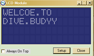

hi Charlie,
I ran in quickly in Oshonsoft and it did display a few characters.
The missing characters indicate that your LCD write delays are too short.

hi Charlie,
So would that indicate hardware fault?
I havent got any pull up resitors as i do not beleibve i need them?
what config bits did you use in oshonsoft?

Which pins on PORTB do you want to use for the LCD control.?
BO and B1 would be fine, this would leave teh uart free and some free for inputs.
charlie
They are now PORT.0 and B.1
This will not solve the delay problems with the LCD.
  • charlie1.asm
hi Charlie,
A simple LCD test program.
LCD data lines [4] on PORTA.low, LCD_RS on PORTB.0 and LCD_ENB on PORTB.1
R/W connected to 0V.
  • CharlieLCD1.asm
