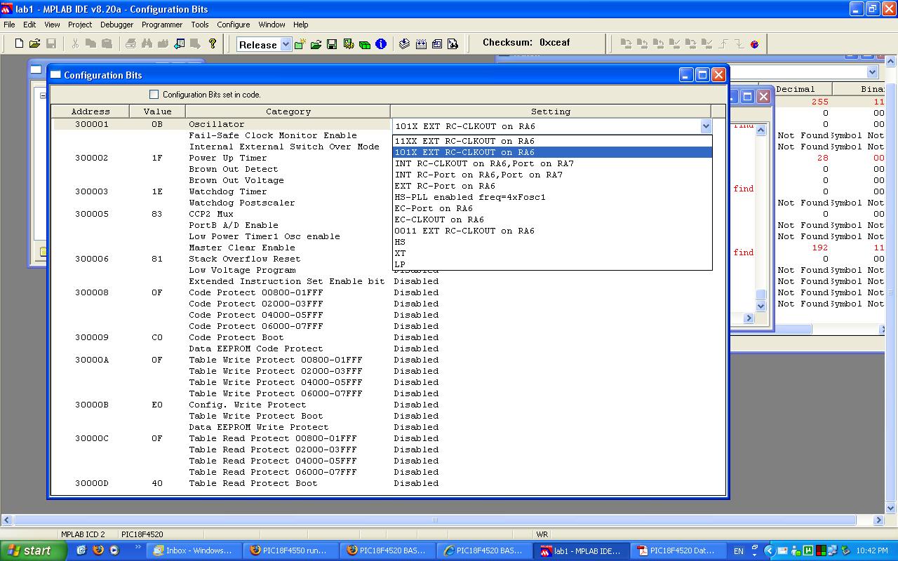

how to check config setting? Could it due to the oscillator setting? Because My oscillator is tap on pin 13 and pin 14 which is RA7 and RA6.
The oscillator setting I check is EXT RC Port on RA6
Hi because I had done MOST of my program already using timer and it is hard for me to turn back to change the whole program because of hardware.
Because this, you had mentioned the CONFIG setting... Do i have to include it into my program ? Is the config setting means CONFIG1H? Then based on my circuit, what do you suggest me to configure in the register?
Yes the CONFIG1x settings should be part of your program. Without seeing your schematic I can't tell you what your config setting should be.

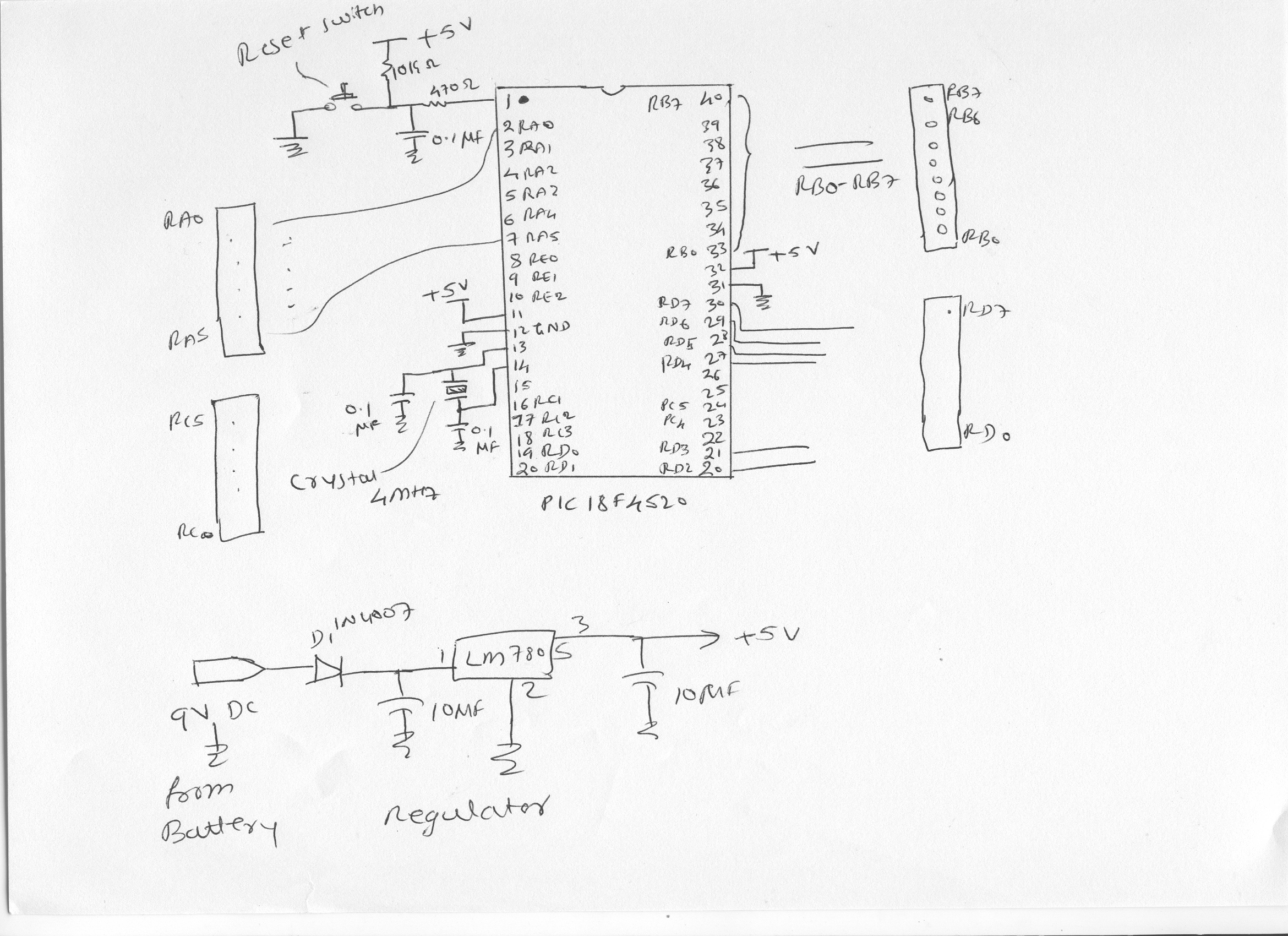

Hi I attach the schematic of my hardware.
I had only attached these pins and I used Multimeter to measure the voltage at Port B.
Pin 1 to MCLR
Pin 11 to +5V
Pin 12 to GND
Pin 13 to Oscillator
Pin 14 to Oscillator
Pin 31 to GND
Pin 32 to +5V

I am not able to use the command "" CONFIG1H=0b00000001; ""
There is a configuration bit where I can adjust the oscillator, I had change the oscillator to XT and Programmed it but it is still no working.
I had attached a screen shot on what is available.

Oh yes, I do have a ICD 2, I used ICD 2 and PIC Demo 2Plus Board to "PROGRAM" the PIC, then I took out the PIC and transfer it to my DIY circuit. That is where it is not working.
After I programmed the PIC with ICD2 and PICDEM 2 Plus, I took out RJ-11 cable and the LED lits up as the program. But when I took out the PIC and put it into my hardware, it is not working.
Try using the internal 4MHz osc for starters, just eliminates the crystal from the problem. You also need those 0.1uF caps near the PIC.
Thanks for your help,
Sorry I would not be able to use internal Oscillator because I had done MOST of my program already using timer and it is hard for me to turn back to change the whole program because of hardware.
do you know anything about the config setting??
