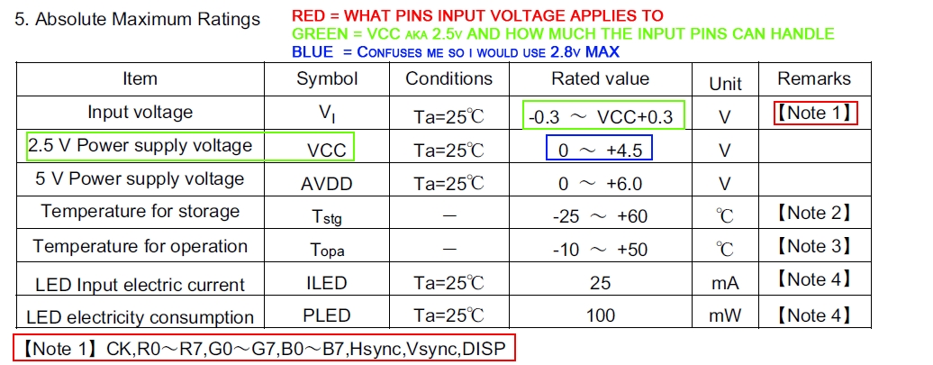

  1. are ALL the inputs eg hsync, display, colour 2.5v tolerant only or can I use 5v

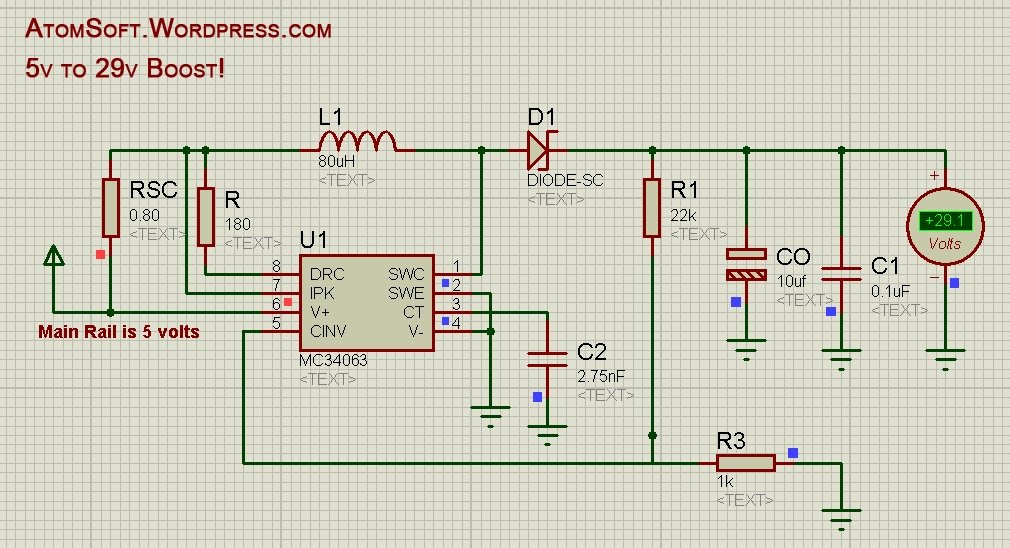

  2. can anybody direct me to a 5V to 28V step-up converter for the backlight

I own that LCD but have not used it. I have made a boost converter. Its somewhere. Search through my topics. Also the Datasheet should have info on pin tolerances ill double check.

I think VCC + 0.3v is the max and VCC is 2.5v so about 2.8v is max on input pins...
Here is a nice image i made for you to see and i understand your confusion.
lcdaaa-jpg.46659
Its funny because if its a 2.5v supply why have a max of 4.5v ? then it would allow for 4.8v Inputs.... confusing...

Would you suggest using a voltage divider on all the 28 pins or suggest another means. I may find a suitable DSPIC that can run at a faster speed and at 3.3 volts or is it still too high if I run the 2.5V logic at 3.3V

Looking at the boost power supply schematic it looks good but it has a high component count. I guess its what you need to get the output 6x as much as the input. however I suppose they are mostly off the shelf components :D
