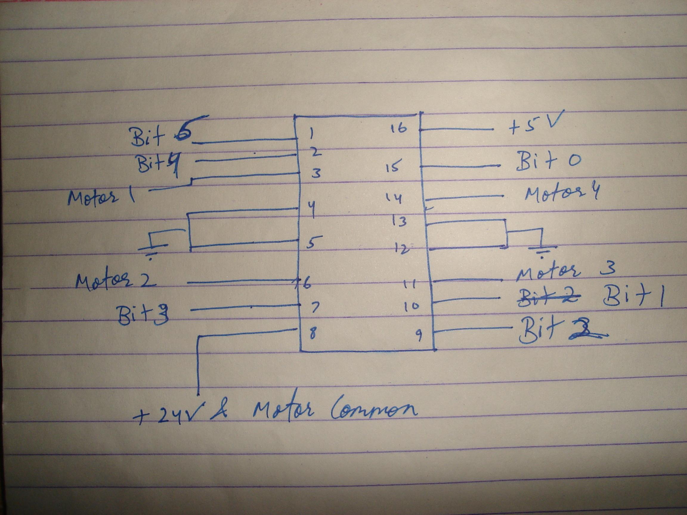

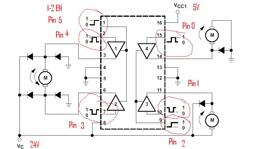

Hello, I am trying to get a motor, PM35S-048, to rotate using PIC18F4550, and L293D. The problem i am facing is that even thought i used the circuit schematic given in hte datasheet of l293d, the motor does not rotate...
The problem is either in the stepping sequence, or in the the schematic i am using.
Here is the source code i am using...

and i have also attached the datasheet that contains the schematic i am using...
  • l293d_2.pdf

How is port C connected to the L293?
Which diagram are you referring to?
What kind of motor is it, stepper?
yes the motor is stepper, and i have specified everything in the post above... the schematic is exactly the one used in the datasheet of l293d...
the portc.0 bit is connected to pin 15 of l293d.

Nope, checked again and I can't find any stepper diagram that shows port C.
You tell us how 1 bit is connected and expect us to guess the other 5. Even though none of the stepper diagrams show 6 driving signals.:confused:

@pommie: here is the schematic with pins numbers mentioned.
@pommie:well, yes. therefore i had to make changes to stuff, i connected each coil of the stepper to one of the output pins and the common one to 24V supply. and i made changes to the stepping sequence also... if you want i can give you an exact schematic of what i am using... give me a minute.
