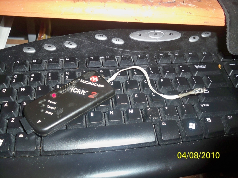

Hey guys ive done it finally lol ... i burnt out
U5: FDC6420C
D4: ZHCS1000
I dont know how.... but i plan to try and repair it.... can someone tell me good replacements? I plan to order them from digikey but if anyone can find better source then tell me

Both parts are available from Digikey.
Apply solder to remove the parts, then clean the pads with solder wick.
It is quite easy to solder the SOT-23 diode; U5 is more difficult. Use a thin tip, sharp tweezers help a lot.
I have all tools just need to order parts... anyone have a idea on how this could happen? or well ... why.... could it be a + / - (POLE) reversal i did by accident?

The USB part broke off so i soldered a new one and i had to reprogram it before using JUNEBUG so i added the header and the FEMALE header got damaged so i added a 2 row female header for stability.. Worked great until i blew it...
