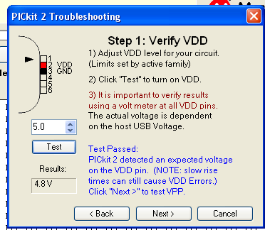

Hello,
I can read and write PIC24H while pickit powers the device, but reciently I realized that VDD voltage isn't correct. If I try to calibrate pickit2, I measure 4,8V, and once I enter that value (instead of the default 4V that appear in the dialog window's text box) the software complains, and I get an error. Basically it is imposible to calibrate. Even if I manually change the supply voltage from the main window, I always measure 4,8V... programming is OK, but I just cannot debug , even setting correctly the EMU pins in the configuration bits (MPLAB IDE complains about voltage, even if I supply voltage externally and tell MPLAB to always use target power).

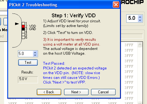

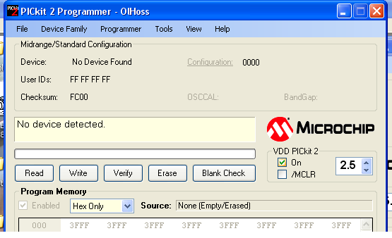

Here some real life pictures the clone can't set the voltage the real pickit2 can
The 2.6 volts is the pickt2 set as low as it can 4.8 is as high as it gets
the 4.9 is the clone it can't set lower there no real voltage control on the clone

True PICkit 2s from Microchip have circuitry to vary the output voltage. Many clones lack the circuitry to do this, and will be fixed at whatever voltage the USB port provides - somewhere between 4.5 and 5 volts isn't surprising. And a hub may provide a different voltage then a USB port on the PC.
Even if the clone lacks the circuitry to change the voltage, it will still show up as an option in the GUI but it won't make any difference.
With a Microchip PICKit 2, you can calibrate the USB voltage. This won't (I believe) output more than the USB voltage, but anything less than that will be calibrated.
