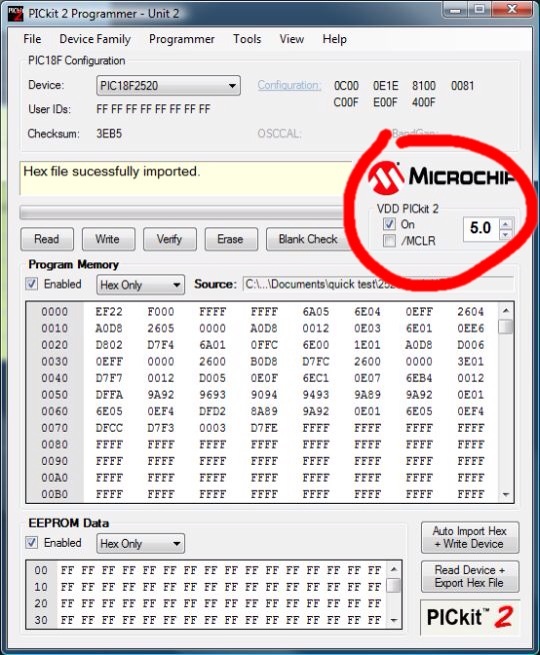

The pickit2 doesn't supply power if its not turned on in software you can't just hook it up and the chip runs..
As Burt said, you have to enable Vdd, and possibly adjust the voltage.

As an aside, the PICKit2 checks the target for power and short circuit. Big filter caps on the target will appear as a short and it won't supply VDD.
Good point Bill. It should be noted that if the PICkit does detect a short, it must be disconnected from USB and the GUI closed and restarted to restart it.
The pickit will also measure its o/p voltage so you can confirm there is juice going to your chip, dont forget to click on the update button to re read the voltage.
If you overload the pickit current wise it'll shutdown, usually opening up a error message.
