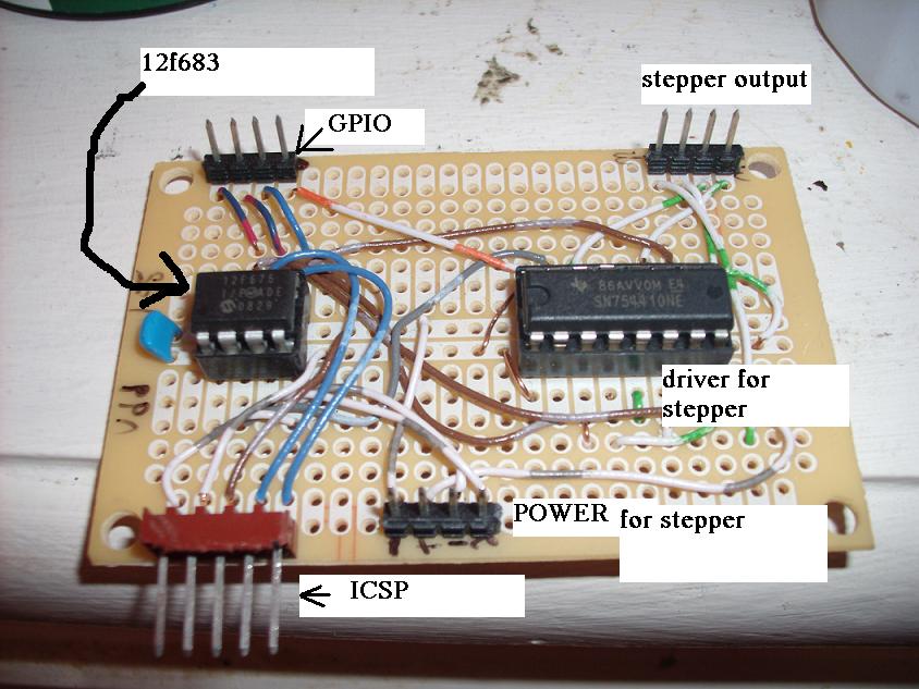

I like to use boards like this

Here take a look at this it for the junebug but it's the same for the pickit2 just the pickits only has where you hook up the ICSP
That's the low pin count board that came with the pickit2 it's a good little board to get started with

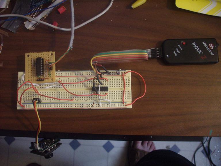

You would be better off using a solder less bread board like this

Hmm I think I'd better look into how the programming / ICSP works before I attempt this; right now AFAIK, the demo board I'm using with the PicKit2 is magical. I have no idea which pins do what or how the pickit2 programs them, which is why I'm eager to use the PICs in circuits and figure it all out. I guess i'd better read up on the theory first. Thanks for all the pictures and explanations guys, I'll be sure to have a good look into these when I'm a bit less clueless.
I was hoping that might be do-able, I was planning on trying that.

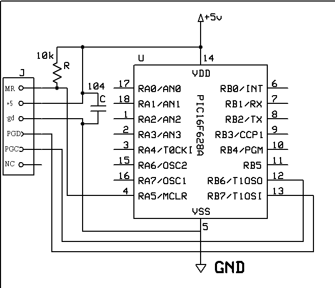

Here this should get you started. The sch is for a 16f628a but you can use the layout for any chip just read the data sheet page 4 on most show the pin out for your chip

ICSP - In circuit serial programming.
What is it all about? It beats pulling out the chip back and forth to the programmer and to the breadboard/prototyping area, and you can program it directly *right* into the prototyping circuit.

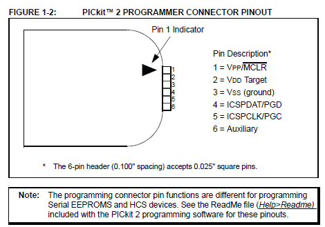

Try to read the PICKit 2 manual - especially the descriptions about each pins inside. And also, don't forget to read the microcontroller datasheet to locate the programming pins. :D

1. how you hook up your pickit2
That's in the pdf that came with the pickit2 if you don't no where to find that here is mine https://www.electro-tech-online.com/attachments/pickit2-user-guide-51553e-pdf.46259/

I would use a bread board **broken link removed**
You can bread board any pdip chip that microchip sells . And if you don't like something you can change it easy > premade boards you for the most part stuck
with what you get.
