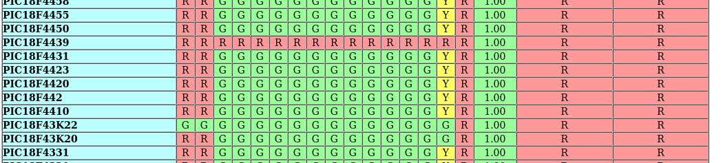

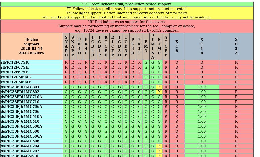

HI Cam There is a file / list [ Device Support.htm ] installed with MPLABX of PICs and the various programmers, Snap is only capable of LVP (Vpp=Vdd) , but your PIC18F4431 although is LVP is not listed as supported.

LVP means programming without the 13V to switch the PIC to programming mode, and wastes some extra pins - it also requires the PIC to be specifically set to use that mode - they come as new set that way (so you have the option) but the first time you program it conventionally you turn that option off.
Note, the 18F4431 is not a new PIC.
Doesn't mean it's supported - the PK2 supports less than the PK3, and the PK3 supports less modern devices than the PK4 - and in turn the PK4 doesn't support some older devices than the PK3 does.
