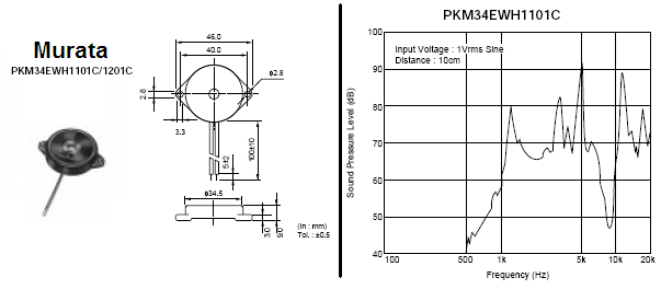

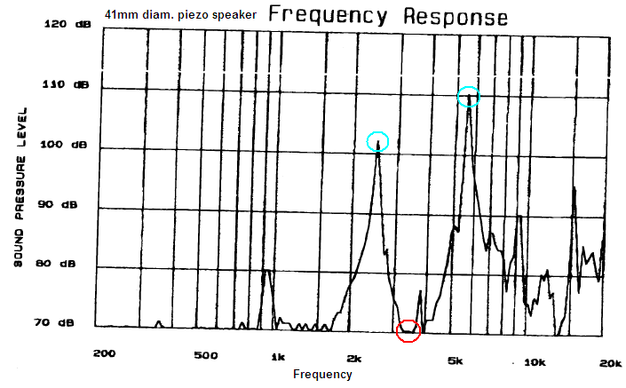

Most piezo transducers resonate at 3kHz to 5kHz where they are sensitive. At other frequencies they have low output as a speaker or as a microphone. Look at this Murata piezo transducer's frequency response that is all over the place:
