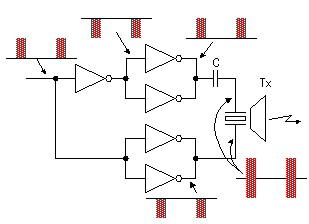

here is the circuit i am using, can you let me know what the problem is realy?
i think i have done what you are saying.

The capacitor in series with the piezo might be reducing the output. The capacitor isn't needed because a piezo is a capacitor.
If the piezo is large then its capacitance is too high for two paralleled inverters to drive without a high voltage loss.

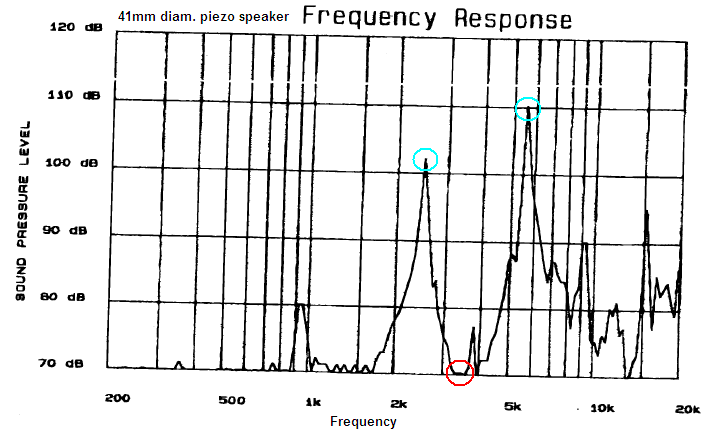

A piezo speaker has very sharp resonances so will be loudest if the frequency is tuned to a peak.
