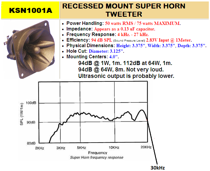

An audio power amplifier that can drive a 4 ohm load can drive 15 paralleled piezo tweeters up to 20kHz.

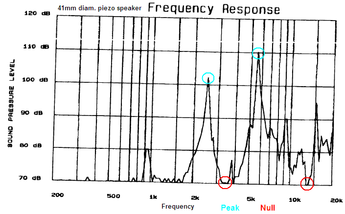

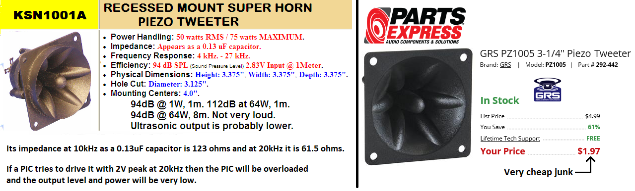

Piezo tweeters were used 50 years ago. I am surprized that they are still being sold as replacements. I found them at Parts Express at a very low price but with absolutely no audio spec's. Reviews say, "Not for hifi".

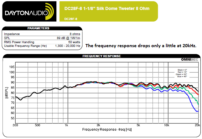

thanks for the great replay - what unit will be the best to get as much volume as possible for freq. between 20kHz - 28kHz
