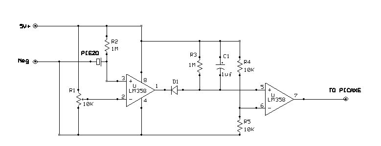

Here is the input circuit for the piezo that i used.
Pete.

What component is the piezo closest to anyway in it's neutral form, can it be considered a capacitor maybe?
Yes, it's essentially a capacitor. Stressing it varies its stored charge distribution and hence results in a voltage change across the element.
The drum allows greater sensitivity as the membranes of the piezo need to be able to flex to produce a voltage.
Yes, I consider if my current testing buzzer isn't too small. It has a round piezo sandwich area of about 8mm diameter on top of a larger metal square, an odd thing tht I've ripped out of some equipment years ago. The buzzer I plan to buy has about 4x times the area. Maybe I don't need to squeeze in an opamp stage before the BC547 to amplify the signal. There's hardly any space anyway.
