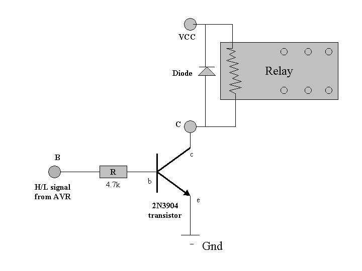

i m using At89C51 wtih 5V supply i m talking about the resistance that lies between the MCU pin and the base of transistor.The 12v relay needs 50mA of current.i m Using C1815 NPN transistor.how can i calculate the base resistance

This circuit will cover most low power relay drivers.
What current/resistance is the relay.?
If the MCU pin is at +5V and the transistor has a Vbe of +0.7V, this gives 4.3V across R1.
If the relay draws say, 100mA and the gain of the transistor is 50,then ideally the base current would be 100/50= 2mA
but ensure saturation of the transistor I would provide a base current of about 4 to 8mA.
So, 4.3V/0.004 =1075R npv = 1K0
Does this help.?
I_desired = NPN_Beta * (Vpin/Rbase) [where Vpin/Rbase is the current sunk by the uC pin].
It's not terribly critical though. Just make sure the resistor isn't so small that the uC pin doesn't get burned out (using I = V/R and the output voltage and max current of the pin). As long as it's just a little bit more current than the relay needs, the relay resistance will regulate the rest of the current for you.
It seem to say 15mA max per pin under "electrical characteristics" so, that means that if your relay current > 15mA x NPN_Beta, then you are fine.
