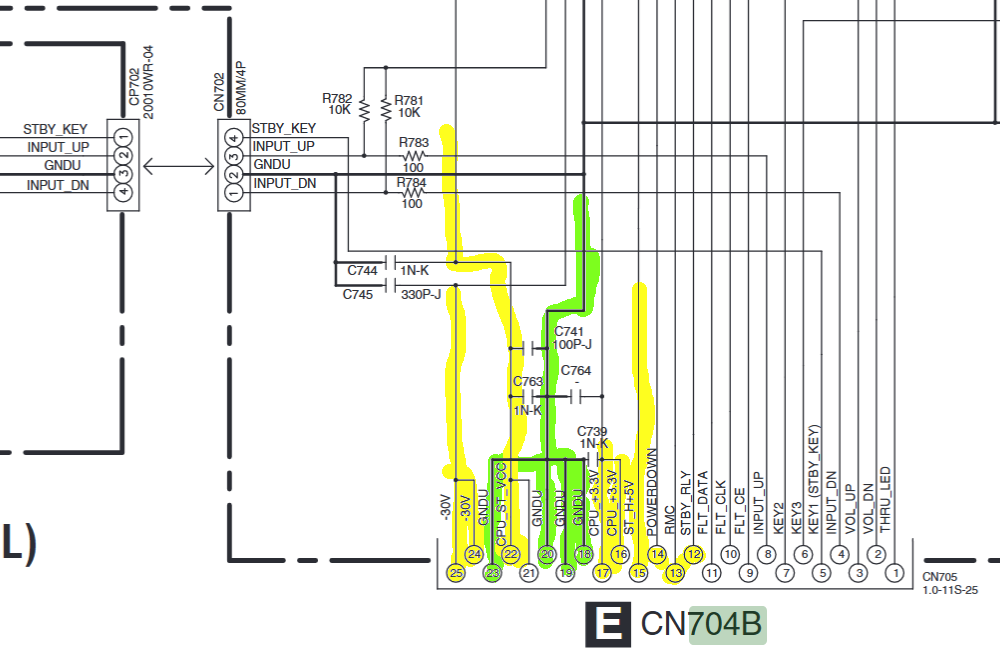

If I looked carefully, and I must admit I'm a beginner in electronics repair, the beow image would be related to the power button, and I see 4 capacitors (2 x 820pF, 1 x 10 nF and C761 that I don't know yet, but probably a 820pF as well), which I suppose could also be a reason why this problem could occur. Am I right to say this? I should use my capacitor discharge pen, and then test them.

See page 71 of the service manual;
C31 and C303 are the most likely ones that could cause problems there.
The main power relay is RLY301 on the same page.
With a multimeter on voltage, test between CP701 pin 4 GNDU (negative) and pins 5, 6 and 9.
You should see close to 3.3V on pin 5 and somewhat more on 6 & 9 with the meter on DC.

OK, that looks like the white one above the red arrow?
If so, it appears you will be able to get to the solder side of the pins OK. Just be careful not to short anything & remember that PCB also has 240V AC on it in other places, at the transformer and beyond!
