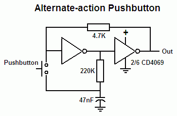

I got the circuit working, but I am having trouble with button debounce. any suggestions?
This circuit is simpler and works well. You can have 3 circuits from one IC or use the leftover inverters tin parallel to boost the current. The capacitor debounces the pushbutton.

Thanks. Ill test it out right now!
is 47nf a 0.047uf cap? Could I use a 0.1 uf cap?
It works amazingly well! The 0.1 cap is a perfect substitute. Thanks!
If you jab at the button very quickly and the supply voltage to the Cmos IC is at 3v which is its lowest allowed, then it might not switch when its capacitor is 0.1uF.

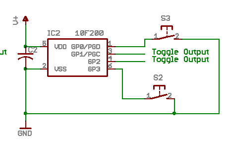

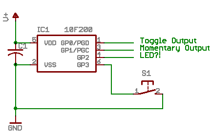

Two different layout ideas for a simple, small and inexpensive toggle switch, using the small and inexpensive (USD 0.60) 10F200 chip from microchip. The chip can be programmed to be a simple on/off toggle, or more complex jobs like a time delay toggle (press and hold for N seconds to turn on), or whatever else you can cram in 384 bytes.
First idea is a single toggle that also has a momentary output and a status LED. Second idea is a dual toggle.
The '200 offers a wake on event interrupt for all its inputs, and also has internal pull-up resistors, reducing the part count and debounce is easily performed in software.
