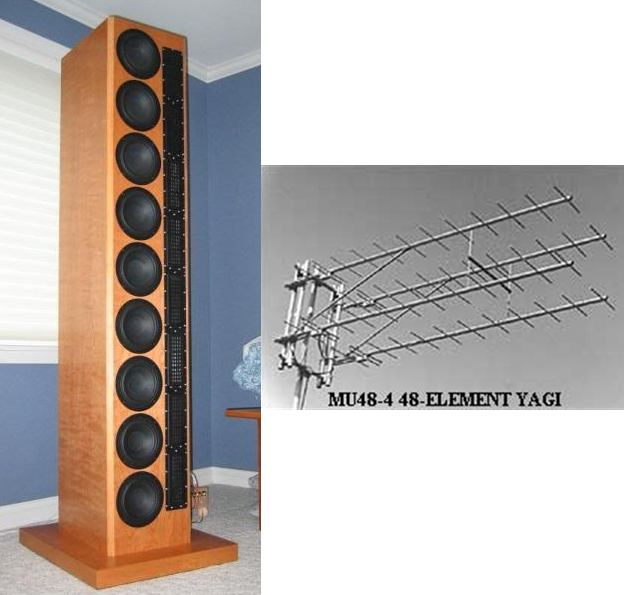

Transmitting and receiving antennas also use an array to gain directionality and sensitivity.
What the heck kind of speaker array is that audioguru?
I found it in Google Images. It has a bunch of woofers and electrostatic tweeters in a vertical array so it beams a narrow horizontal beam of sound that does not bounce off the floor and ceiling and it concetrates the sound making it louder if you are in the beam.
