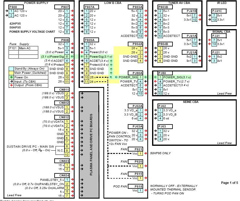

I am trying to fix this plasma TV. Basically when power is applied and all boards plugged in, there is a relay click on the PS, a cooling fan runs for a few seconds, then the system shuts down with a red blinking light. I found the attached pinout of the PS and trying to verify if the PS is actually my culprit since I just cannot find much wrong with it yet.
I am looking for an experienced TV tech to tell me if the "standby" pins should see power all the time whether anything is plugged into the board or not? When I apply 120V to the board with absolutely nothing plugged into it, I get 5VDC on the standby pins that call for it but there are no other voltages present. If I should see these standby voltages on the bench, that would just confirm that I am at least on the right board.

Unfortunately you rarely get circuits for Plasma TV's, repairs normally consist of board replacements, while they are still available.
If only the standby voltages are present, it 'probably' means either the main PSU section is faulty, or it's not been instructed to turn on by the control section.
Presumably the PowerSig line is what turns it on?.
Maybe I was not clear, some of the standby voltages are NOT present. I was tracing through the board and it looks like the bridge, and main part of the PSU is not active until the relay fires over. That being said, if the "standby" voltages should be on as soon as the board is plugged into power, there is certainly something wrong with the board. I guess it is "somewhat" easier to trouble shoot since about 90% of the PSU is dead until the relay is fired so tracing is somewhat easier. That being said, I am still trying to figure out how AC power is being conditioned for the standby outputs. I DO have the 5V out but that is it. All my transformers, power caps, bridge, etc are all dead without the relay switching.
I was just hoping to find someone that has experience in troubleshooting to say "yeah, if the standbys are missing, there is an issue with the board". Or, maybe there is still some type of switching circuit here to turn on these standby voltages.
That is why I posted the diagram because it lists I think 3 standby voltages. There is a 12V, 20V, and I think 32V listed on the sheet above. Of course this may all be hearsay if that chart is not right because it was just an Inet find....
I was able to find a new board for 100 bucks from a guy but I guess I do not like to get beat and still trying to educate on SMPS repair since I keep running into it. I could be chasing my tail if 5V is all that is supposed to be present.

Look at the the color code chart. It tells you which signals are present always! I'd be looking at POWER_ON and ALARM signals as well.
