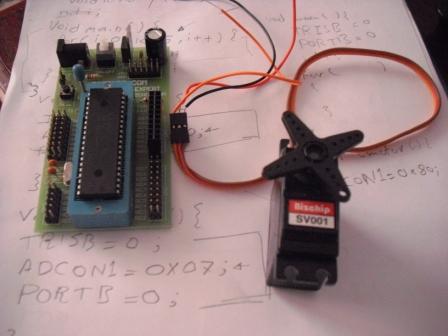

I am somewhat confused :confused:, the truth, I tried writing a program to move left and right motor servo with( Pic16F877A) periodically, but the problem is moving in one direction, I did not know what is the problem Does anyone can write a simple program so that the experience, learn them
I have seen a lot of sites but does not explain the code may be the ideas advanced :(
Do you still have the code? Can you post it for us?
If you have a digital camera, can you shoot a quick video of what the servo does and put it on youtube (or some other site)?
If you could do those 2 things, I bet we could find the problem very quickly.

:p A tribute to all, I do not have a lot of experience in programming, but easy is to try to help and I hope I wrote a simple program I do not know may be a big mistake, or far from the target and use the program mikroC
I want (the operation of servo motor to the right and in a moment due to the left and frequently)

the program
________________________________________
//Servo Motor Auto-Mode Test
void lmotor (void);
void rmotor (void);
void main (){ int i;
for(i=0;i<5,i++){
void lmotor ();
void rmotor ();
void lmotor () {
TRISB = 0;
ADCON1= 0x07;
PORTB = 0;
void rmotor () {
TRISB = 0;
ADCON1= 0x80;
PORTB = 0;
