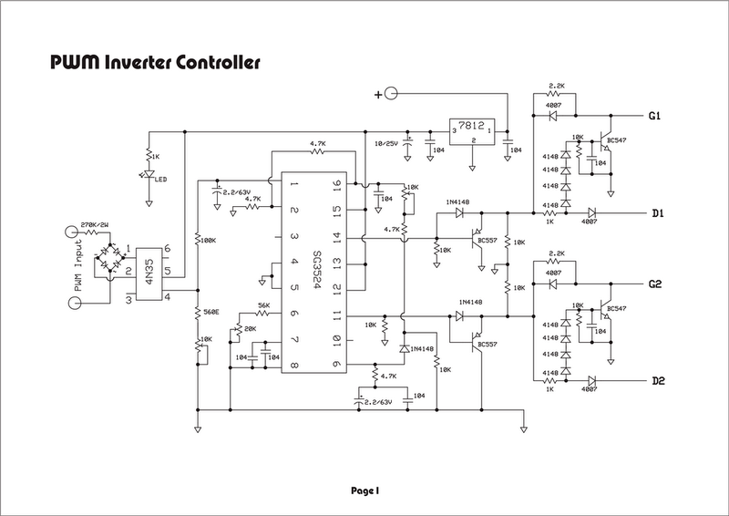

I just learn the world of electronics, and I make it as a hobby.
After i looked for inverter scheme on google, Finally it's complete enough.
Even the output is a square wave (square wave),not a sine wave (sine wave), but I think this scheme is enough for me.
My opinion : In this scheme there are 4 separate images, namely:
Page 1 : PWM Inverter Controller

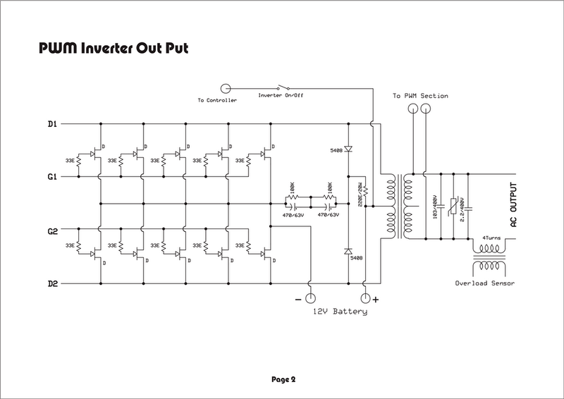

Page 2 : PWM Inverter Out Put

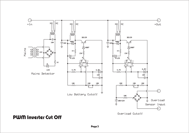

Page 3 : PWM Inverter Cut Off (Automatic Low Battery Cut Off, Mains detector to automaticaly switch On/Off the inverter, Automatic Overload Cut Off)

I have some questions for you guys, that already long study about electronic.
and the questions are :
1. On "Page 2: Inverter Out put" there are resistors 33E adjacent to the MOSFETs, How many ohm the resistor 33E? Does the 33 Ohm. Like that?
2. On "Page 3: PWM Inverter Cut Off " there is a description about +Out and +In, what does it mean? and what about Over Load Sensor?
3. On "Page 4: Lead Acid Battery Charger" there are two 15A Diodes, as long as I know the Diode on the market is only up to 6A, and the Diode more than 6A there is usually a label on Ultra Fast Diode, it looks like a Transistor,but it only has 2 foot, can i use Ultra Fast Diode MUR 1520 on diode 15 A?
That's my questions.
