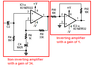

it doesn't matter which way the electrons move. Instead you need to learn about the function of the circuit blocks.
Didn't you learn anything about extremely simple opamp amplifiers??

Further to AG's post, the first circuit block AC couples the input signal via capacitor C2, so any dc bias voltage that is applied to the + input of op amp IC1-a is not upset by any dc voltage that might be on the input signal. This is a standard trick. It just so happens that the + input of the op amp is clamped to ground by R4. Since the amp is powered by + and - supplies, R4 clamps the input to exactly half way between the 2 (0V), so you can get fully swing on your input signal before worrying about hitting the rails.
Now, you only really want to amplify the signal (ie the AC), not the DC, so if any dc voltage does sneak into the input of IC1-a, you dont want to amplify that too, so that is what C4 is doing. We know capacitors have an infinite resistance at dc, so C4 ensures that the first amplifier has a gain of 1 (1+33k/infinity) at dc, but its resistance goes down with increasing frequency, so C4 provides more of a short circuit to ground for the bottom end of R6, thus, at ac, you can consider C4 as being a short circuit - so you just have a gain of (1+33k/1k) - another simple circuit block...
It takes time to recognise these, but dont be put off. Keep plugging away and you'll get there!
I think you should try to split the circuit into blocks.
The first Step ist to split it in 2 parts, because it is stereo.
Then you should try to split it into Basic circuits.
Like:
1 Circuit: IC1A, R8, R6, R4, C4 you get an non inverting Amp with a aplyfying factor of 34 with an Input Impedance of 1MOhm ( parallel with the input Impedance of IC1A).
C4 decreases the amplyfying factor for lower frequencies an DC.
2 Circuit: IC2A, R10, R12. Thats an inverting amp with an amp factor of 2 that is switchable in by S1A.
3 Circuit: IC3A, R15, R17, R19, R21 Thats an inverting amp with mixer (R15, R17) and an amp factor of 10. R21 is an "Fuse" resistor to avoid direct shorts at the output of IC3A.
4a The input: R1, C1, R3 - R1 and C1 give you a filter Function for the power supply. R3 is a load resistor, i think into the input should be connected a electred condensor micro that needs phantom power. C2 is a couple condensor to avoid DC at the Amp's input.
4b second input: R23a Thats only an additional input for higher levels.
5 Level: R14 is the level pot for the first input.
The single blocks are basic circuits, you need some experience to check that. But when you get that it will be quite easy.
So you should learn the basics and such an schematic in no more a problem for you.
I think the whole schematic is an microphone amplifier with micro phantom supply an an additional line input.
