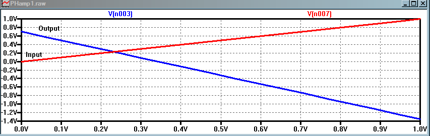

The gain of the 2nd stage is -G = 100k/100K = 1
and the NInv gain +G = 1+ 100K/100K =2
So the +0.35V on the NI input gives a fixed voltage on the output of +0.7V
The Ph signal from the first stage changes the level of the +0.7V
Have you details of the output from the Ph sensor, so that we can complete the calculations.?:)
The 2.2uF cap across the 2nd stage acts a signal integrator LPF.

This is a rough plot from LTSPice of your circuit.

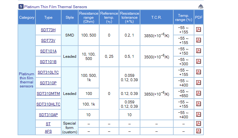

can you spot the correct one ??? i am asking for a help cause i cant find the correct one ... i first thought it would be a thermistor...
i googled it too ... i got random sites ....
that why i asked to spot the correct resistor from a site like farnell.com ... only if you have the time for it..
as far as i have learnt thermistors are temperature varying (compensating) resistors .. so why cant we use them??
You require a 'linear' change of resistance with respect to temperature of 3500 parts per million per degree Centigrade,
generally thermistors are not linear.
I have tried Farnell for you with no success.
