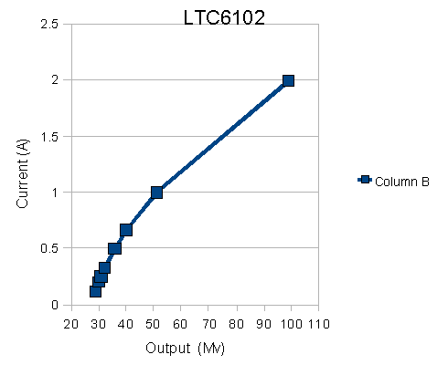

Noel... Using a lamp at 3 ohm through 48 ohm ( 120mA up to 2 A ) I've plotted a graph.. (I'm sorry the graph reads 200, it means 2000)
It isn't linear The reason your readings are wrong is the lamp modeled had 200+ ohm.. In reality they are in the order of 6 ohm 6v, 6 ohm = 1A...
This was with an Rsense of 0.001..
You will need a curved chart to evaluate the current..

This is what I ended up with
		ADCON0=CHANNEL3;				//CHANNEL1=0b10001001 //CHANNEL0 is for Temperature
		lcd_goto(48);
		read_adc();                     ////It seems Reading the adc first ***important      ////This function generates the average reading value of ADC
    	current=read_temp();               // reading value from sensor       ***important	   	////This function stores the generated value by ADC into the variable "temp"
		if (current > 56)     // equates to 120mA... lowest reading
			current *= 500;                        // 5.00 volts
			current /= 1024;			// covert to voltage..  1024 bits
		else current = 29;      //Minimum mV reading
		current = (188 * (current-12)) / 73 ;   // convert to current.. 188 is current span...73 is mV span.. 12 is minimum current 120mA)
		current /= 10;
      	dis_num(current/10);               //show the value
		send_char('.');                 //this line is to show . to seprate desimal value from double value
		dis_num(current%10);               //show the double value
		//current=temp;
		send_char(' ');
		send_char('A');
		send_char(' ');
I had to define current as a long as one of the math routines was going negative... (even though you had unsigned short... go figure)

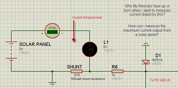

Thanks Ian so much for your efforts on LTC6102, however i found out there is no LTC6102 IC available within Malaysia. Therefore, i am going to change my design to the other ways of measuring current.
I have an idea. Lets say we measure the current using a shunt resistor of 0.01 Ohm (100Watt) and feed the small voltage (good enough not to bother PIC) to the ADC. I have already bought the expensive shunt resistor. my problem over here is that the time i put a small value load (resistance 10 Ohm) with voltage of 5 Volt, the 0.5 A makes it hot. Even though i am using 3 Watt resistor, still the same thing happens.
I feel i am confusing somehow now. Please give me a brief explanation on how i can measure the maximum Power output from Solar panel. (It is the Vmax * IMax=PMax right?) we already can measure Vmax, but how about current?
Is not it like putting a small value resistor to measure the maximum current output? why it burns my Resistor with even low voltages? I have asked from outside shop that the big big solar panels for experimental usage normally give 50Watt and 20 Volt which it means the current output basically is low in ampere, but still i am unable to come out with a stable idea or design to measure it. Please help me to clarify this for me. I feel shy that even basic electronics sometimes become confusing for me. Please see the the picture for better illustration of the design.
