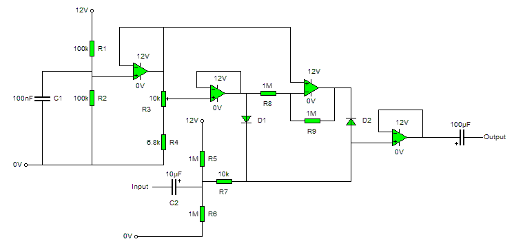

I forgot to number the op-amps in my schematic, for the purposes of my explanation below, the op-amps are numbered U1 to U4 from left to right.
R1 and R2 divide the supply voltage by two, giving 6V in this case. U1 is a unity gain follower with a high input impedance and a low output impedance, which buffers R1 and R2 thereby reducing the output impedance from 50k to near zero.
R3 and R4 provide the variable voltage you require. The output voltage will depend on R3's setting and will always be below half the supply voltage.
U2 acts as a unity follower to reduce the impedance from R3.
U3 is an inverting amplifier with a gain of 1, it inverts the signal from U2 so it's added to half the supply voltage.
For example, if the output voltage from U3 is set to 4V, 6V-2V, the output from U3 will be 6V+2V.
Look at it another way, U1 forms a virtual earth circuit, its output can be considered 0V and the supply rails +/-6V. If the voltage on R3 is -2V, the output voltage from U3 will be +2V. R3 and R4 could just've easilly been connected from the positive rail to the output of U3 to give a positive voltage but the diode polarities will need to be reversed, you'll see this later.
R5 and R5 bias the input signal around half the supply voltage (or 0V if you choose to see it as a virtual earth).
D1 and D2 will clip the input signal to 6V +/-2V +0.6V (assuming the output voltage of U3 is 6-2V).
You are also using capacitors, are those to alter frequency or to block signals?
The capacitors just block DC and allow AC to pass through.
The following formula can be used to calculate the minimum capacitor value required to pass the lowest frequency of interest.
[latex]C = \frac{1}{2 \pi RF}[/latex]
F is the frequency, R is the load resistance and C is the capacitance.
For example
[latex] C = \frac{1}{2 \pi 10 \times 10^3 \times 20 = 795.8 \times 10^{-9}} = 795.8nF[/latex]
The nearest value up is 1μF.

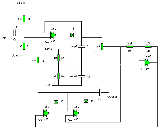

That's a good idea, maybe the first op-amp could be better used as a precision rectifier to automatically adjust the clipping limit?
I'll have a look if the OP is still interested?
Here's an adjustable clipper with a peak detector.
This circuit is not buffered like the one I posted previously.
If the source is high impedance and the load is low impedance a couple of buffers will need to be added.
You'll need to use quite a fast op-amp because the op-amps go in and out of saturation at double the fundamental frequency of the signal.

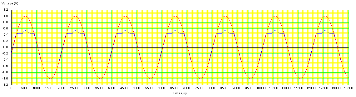

Hi there Hero,
Looks interesting...did you by any chance do a simulation to see how it responds?
I did a quick simulation in an old version Crocodile Technology, a kid's simulator which I like because it's easy and is real-time. I haven't simulated it with LTSpice of any real software.
It work all right, there's a slight glitch at the top of the positive cycles which is because of the peak detector but I don't see how it's a problem because it's a distortion circuit.

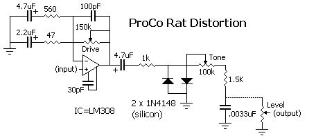

First of all i wanna thank you for all you've done.
Though you're circuit looks great i was having my doubts
about what makes a signal sounds good.
Looking on the net i saw that its really important to have just the right
amount of sustain, the reamain of instrument timbre, have ass less intermodulation
(sounds bad when playing chords), etc.
I found it take all these factors in consideration. Thats why i wanted to
post some effects that are already confirmed sounding good, and let you guys
analyze them. (if you feel like it)

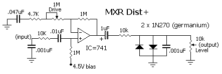

Here are the schematics (thanks hero:p)
I found these at:
GM Arts - Guitar Amplifiers
The most notable difference to me with hero's schematic, is the way the diodes
are connected. They're in the feedback loop and thats probably why they apply
to all signal levels. The limiting isn't adjustable tough is at is in hero's;).
I'm hoping someone can explain these a little to me(espacially how the op-amp
does its thang:))
Thanks again:D
The first and last schematics you posted are fixed clippers, all signals under 0.6V peak at the output of the op-amp won't be distorted at all.
The one with the diodes in the feedback look won't distort at all at lower frequencies <100Hz or so and will be greater at higher frequencies.
