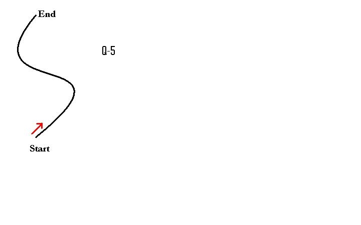

Q-5)Imagine a simple line follower track (as shown here) of black color on white surface. The robot comprises a chassis, two wheels, two motors, a motor driver, a battery and few discrete electronic components and just one IR Sensor Module. The robot (represented by red arrow) is placed as shown below. What should be the logic based on which the robot will follow the track and reach the end point? (Please give a high level logic which involves color of the surface and the robot direction only. We don’t expect you to go into the motor driver control, comparators etc.)

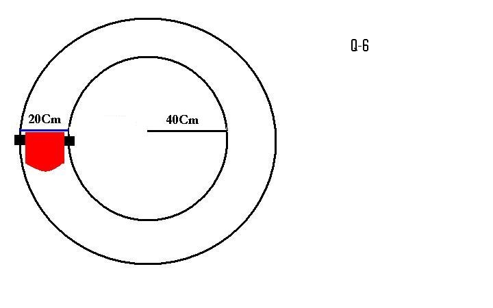

Q-6): Imagine a two-wheeled robot as shown in the figure here. The robot has two DC motors with rated speed of 60 rpm. The distance between the two wheels is around 20 cm. What should be the operating speeds of both the motors (outer and inner), such that the inner wheel covers a circle of 40 cm radius (as shown) in fastest possible time?

Q5 have you thought this one through at all? Think about what should happen (a) if the sensor can see black, (b) if the sensor detects a black->white transition and (c) if the sensor detects a white->black transition. If the sensor detects white->black, how do you know which way to turn? Should the robot follow a line or an edge?
Q6 interesting, I would have thought this was dependent on the radius of the wheels. But this information is not given. Maybe it isn't, or perhaps the radius divides out. So assume a radius of x, or think up a number of test radii and work it out for each. But where are you stuck; this seems fairly simple to work out. The outer wheel needs to go faster than the inner wheel of course, so you can't have the inner wheel going at the maximum 60rpm.
