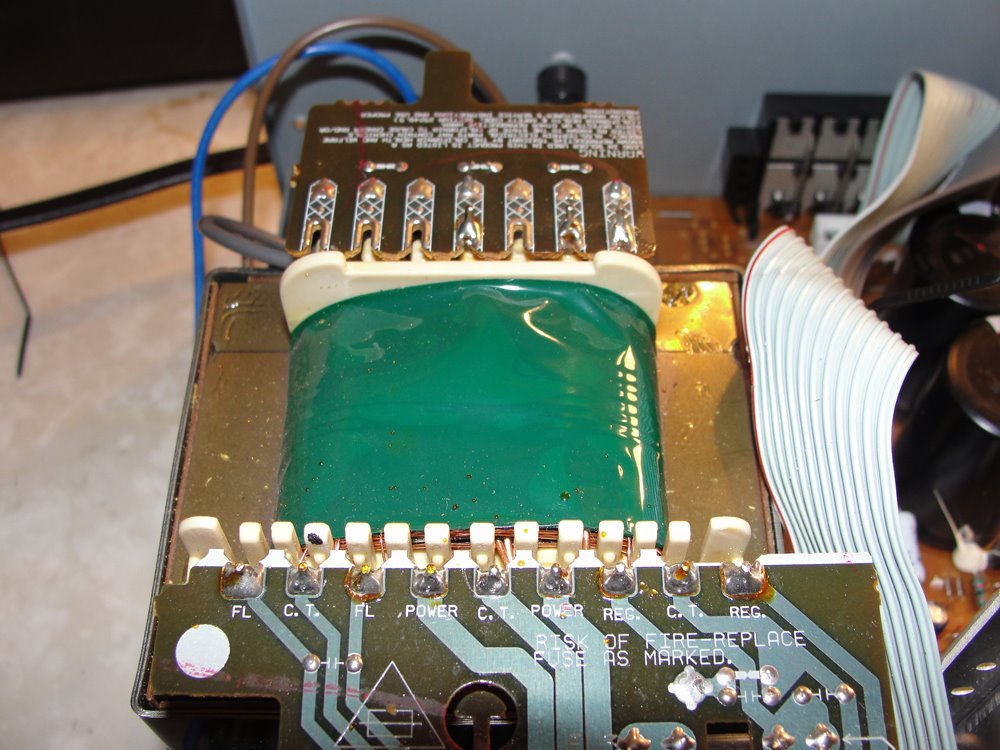

please identify and define these transformer terminals for me?
sirmikeylikesit
I have continuity between all pairs of labeled terminals except the first CT and the second CT does this indicate a bad transformer?

The CT terminals are center taps of the respective windings. They aren't connected together inside a normal transformer. The CT beteen the FL terminals should have continuity to them; between the POWER terminals same, and the CT between the REG terminals should have continuity to them.[/edit]
Here's the picture: https://sites.google.com/site/orotundindustries/work-space/transformer.JPG

we , as user, can only identify them as three different center tapped windings.
any common connections found could either be thro' the circuit or possibly a fault inside the windings.

the out puts are 3 isolated windings, supplying to external boards maked as power, FL, Reg, all are centre tapped. if there will be any reading between the sets (FL, CT, FL) , (Power CT Power) or (Reg CT Reg) when the transformer is pulled out, then its confirm that there is a internal fault.

yes we dont know thats why i mentioned may be..., at the same time for sure its not for a MW oven or a washim machine, just have a look of the PCB on the picture, you can see line in/out sockets at far,thats why i am pretty sure its a board in a cassate player or any other with am amplifier. by the way FL mark is not for internal of transformer, its for external PCB tag.
FL is a higher voltage low current winding for the fluorescent display module on the appliance. Note the thin winding wire and low current PCB tracks.
POWER is very obviously lowish voltage high current based on the thick wire and high current tracks with very minimal isolation between tracks.
REG is the +/- 15v or so needed by the preamp etc.
Looking at the block of RCA connectors on the back panel and huge filter caps it's very obviously a power amp, based on mainly through hole components it looks like an older (late 80's or early 90's?) hifi amp.
Just power the transformer up and measure the AC voltages on its output pins.
