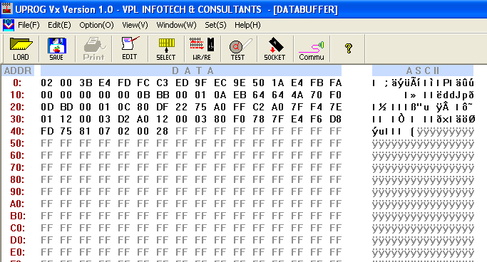

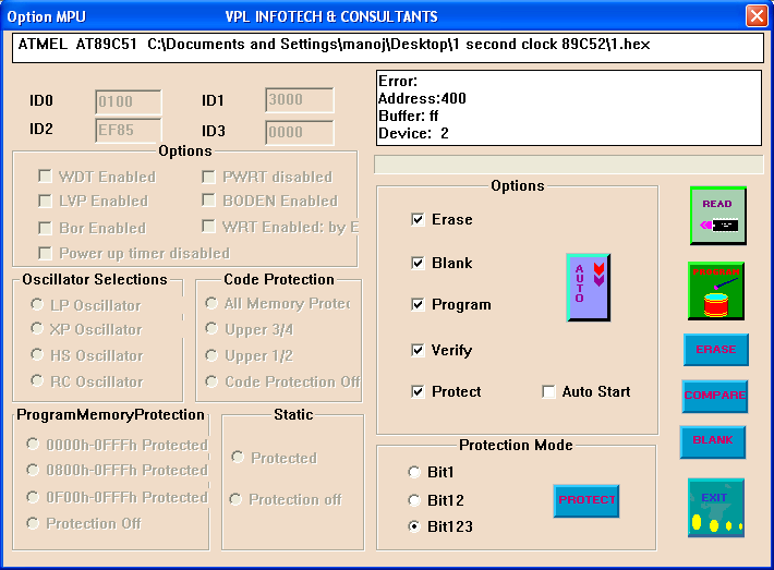

I am burning a hex code into 89C51. But I get the error message and chip not function...Can anyone knows is it programmer Error or Programe Error? Befor two days I programed another chip and its works.
Is it the Burner Software Error?
I attached the screen shot and the hex code.....

I'm not familiar with your programming software, but from the screen shot it looks as though you are trying simultaneously to erase the chip, fill it with blanks and program it. Don't see how that can work.
