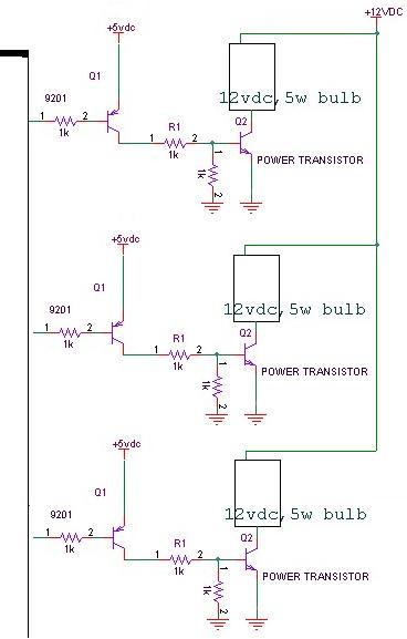

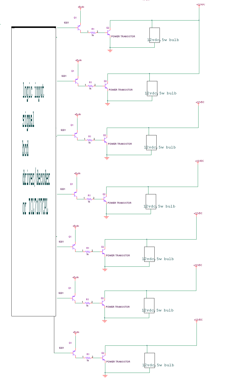

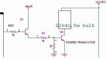

In our design we used a BJT npn power transistor for each segment.But the real problem that we counter is in the part of having a large segment display for a common anode display since the IC ICL7107CPL REQUIRES A COMMON ANODE DISPLAY but in small scaled value of power just like in an ordinary segment display only that we transform it and design a large segment display.Attached herewith is the sample testing of bulb for two segments. The problem is that the bulb does not outputs anything even the signal is logic 1.However, the bulb lights on /outputs correctly when only one bulb is connected from the input signal for the testing of inputs and outputs.Whats wrong with our design?.

For a start, the power transistors are shorting the 12V rail out, as soon as one turns on - BOOM! - depending on the current capacity of the supply, which is likely to be pretty high when feeding car bulbs.

The output of the ICL must be low to drive Q1 and Q2 and to supply current to the bulb. ( is this how y expect it to work)
Than connect the bulb between the collector of Q2 an de +12 Volt.

ACTUALLY,the operation on the circuit is that when the icl7107 outputs logic1 the Q1 does not operate and so there is no current that will pass through the base of Q2 and so Q2 Colletor to Emitter part is open and so the current passes to the bulb and then the bulb lights on.Moreover when the ICL7107 outputs logic0 the Q1operates and passes current to the base of the Q2 and hence Q2 operates shorting the Collector to emitter and so the bulb does not lights on.Our problem right now is that when more than one bulb is connected from the ICL7107 considering all the connections with those transistors, the bulb does not lights on even the signal is logic1.

The bulb must be in seriel with collectors, also need some extra resistors for current limiting from ICL output, and another for power transistor proper closing. The driver transistor supply 5V (better the lower for proper closing of PNP transistor) must be separated from ICL supply.

like it is in the drawing of sebi now: if the output from the ICL is high there is no current.
"IF" you want it otherwise, Q1 must be another type of transistor: Also
een NPN
How it works: A small current goes from the base to the emittor in Q1, this allows the Transistor to open a path for a higher current from the emittor to the collector. The emittor current from Q1 is the base current from Q2 which its turn amplifies the current, and supply a sufficient current for the bulb from emittor to collector.
The bulb itself limits the current.
The value of the resistors depends on the choosen transistors.
The one between ICL an Q1 can be higher.
For this drawing: ICL = 0 bulb is off, ICL=1 bulb is ON

Actually Sir Q1 is not an NPN Transistor but a PNP transistor since the device ICL7107 does not provide or source current but accepts or sinks current from the device itself.And so that is why my design the bulb is not in series with collector of Q2.

e_l ,the circuit looks OK except you should put a higher value resistor between the base and ground of Q2, something to compensate for leakage and still pull the transistor low, say 10K-50K or so.
The 7107 output is active low, because originally designed for common anode 7segment led display, so the common anodes sitting on +supply.
When the output low, the pnp transistor conducted (opened) and drive the power trans. base from +5V so the PWR trans. also opened. The current flow from +12V via PWR trans. c-e, and return to GND: so the bulb light.

Thanks for reminding me Sebi.ICL7107 is actually an active low component.Hence the design must be like with your design the bulb is in series with the collector of Q2.We are yet to test your design.
