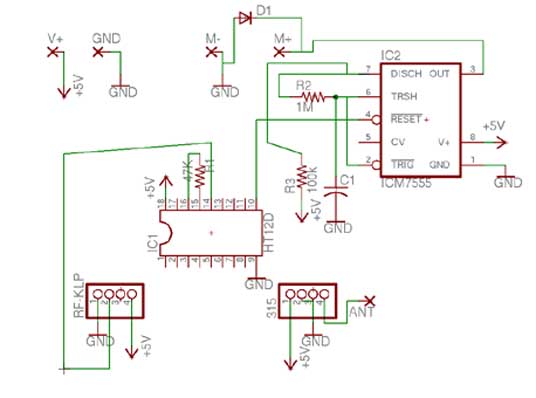

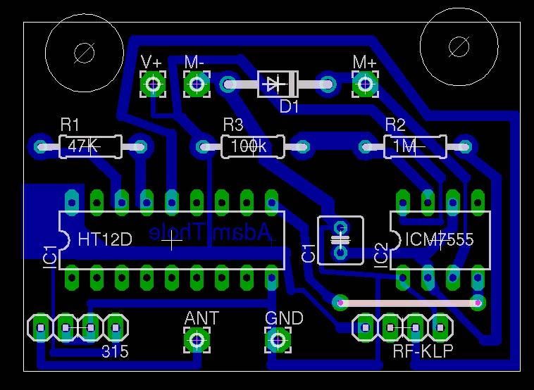

Everything looks correct to me, assuming you are using the BIAS thing correctly. I have made several circuits using the HT12D and the the Laipac Receiver, so I am familiar with those. BTW, did you make the HT12D and Laipac Receiver stuff in Eagle or was it in a stock library?
I used eagle for my board, but I just used a generic 18 pin DIP for the HT12D and pin headers for the RF receiver. If those aren't stock libraries, I would be interested in using them, if that's cool with you.
Here is my schem/board...if your interested. Notice mine is used to enable/disable a 555 timer that then powers a dc motor.
