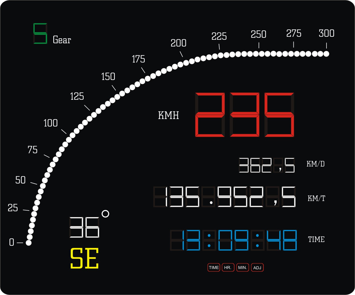

here is the Speedometer i would like to build, and need your help to it.

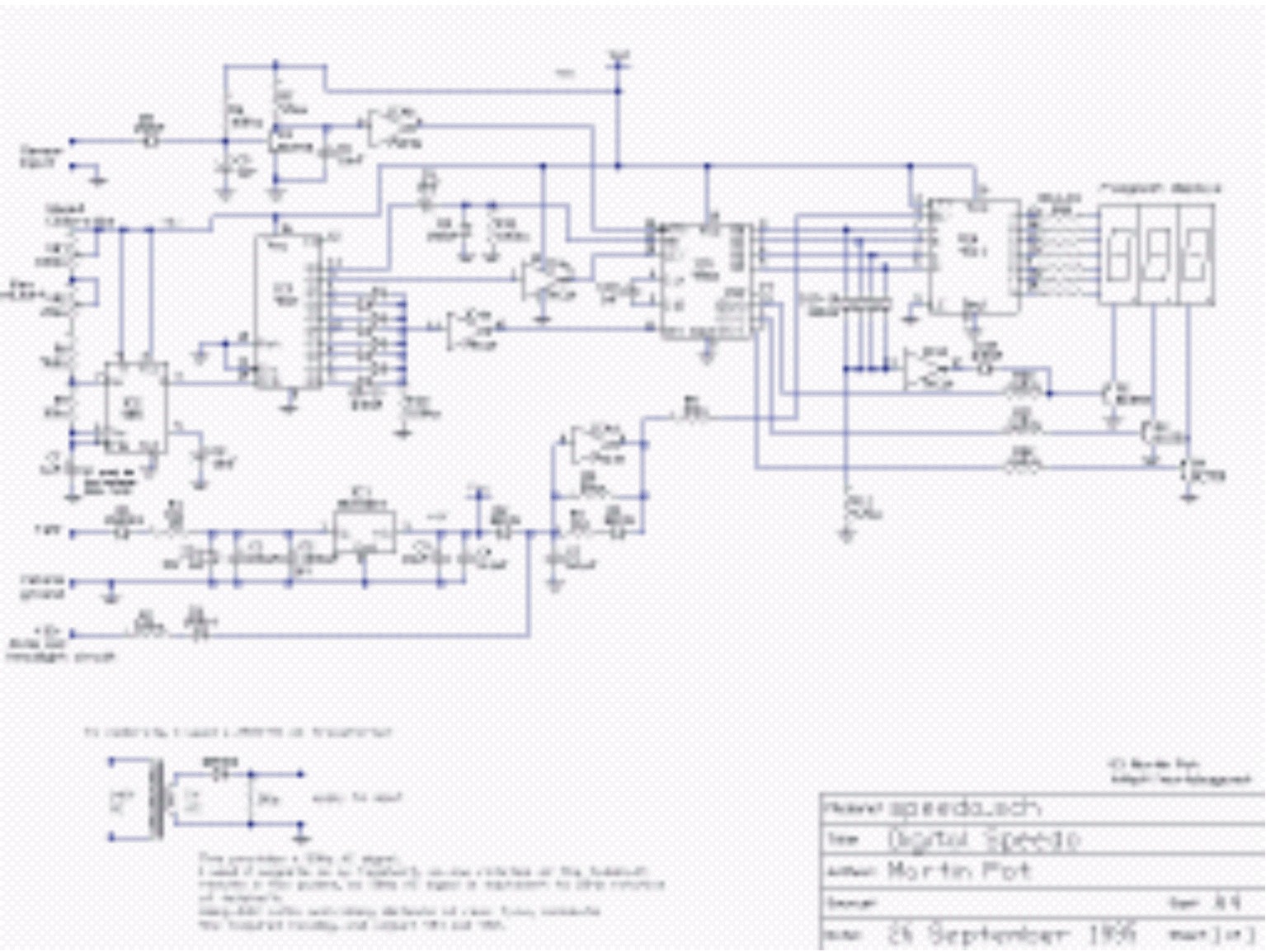

I went trough all the postings, and all i could a find is a part of it https://martybugs.net/electronics/speedo.cgi
now i would need the schematic of the LED's, so i could combine the two circiuits together, OR somebody has maybe some better solution, PLEASE uyou are most welcome

Do you need a circuit to drive the 100 LEDs in a bar graph?
Have you ever seen an LED display outside when the sun is shining? It is difficult to see unless there is a big, ugly shade over it.
yes Uncle,
i need a schcematic to drive does "100 LED's", and thats why the speedometer is buid in digital as well.

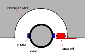

i think here is a reasonable idea for the sensor speedo_sensor_tunnel.png and the circuit SPEDO 4.jpg, so it maybe changes your mind from the 5th wheel - to.................. ????

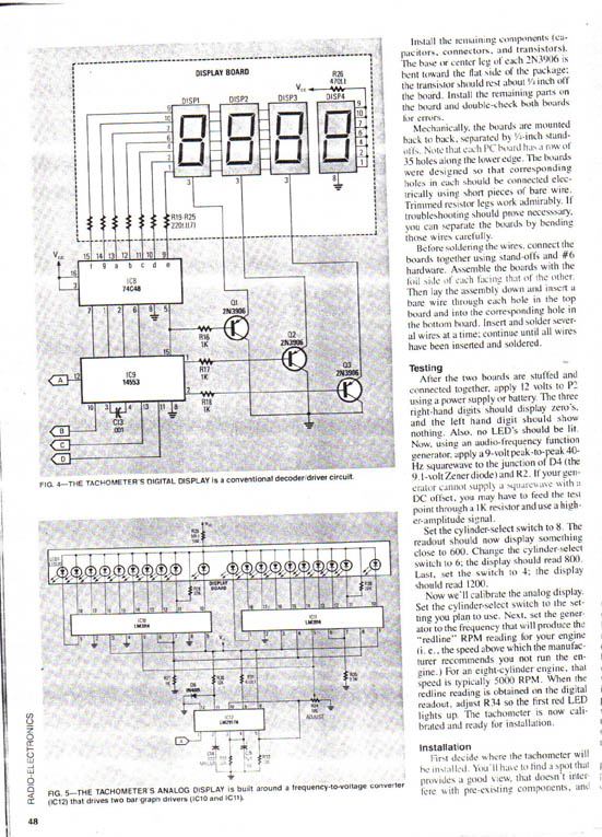

You are not going to make a bar graph with about 100 LEDs with that very fuzzy schematic of a 7-segment display circuit. You need an LM2907 or LM2917 tachometer IC and a bunch of LM3914 bar-graph driver ICs.
here is a circuit of a tach but can be converted for speedo app there is 7 pages so if that what your looking for let me know and will send them to you by email only.
