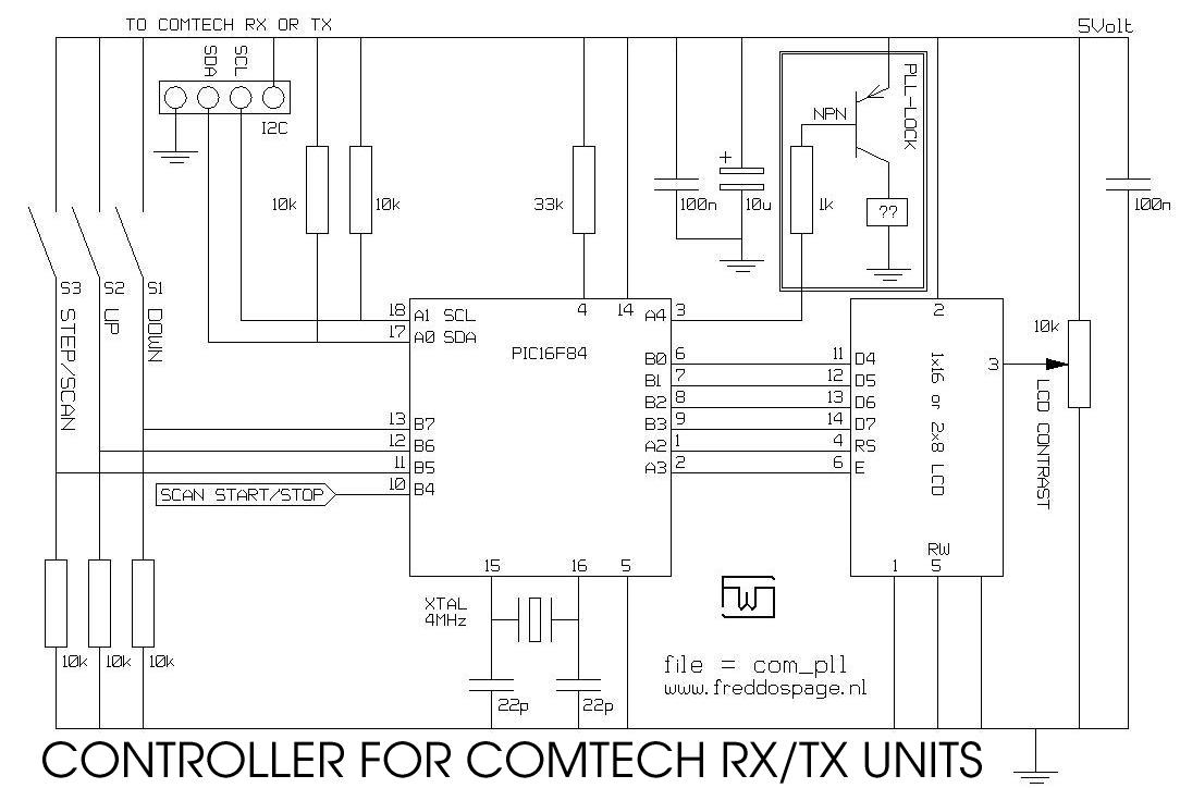

Can you post a schematic of what you are talking about?
You say it is working, so you must be able to send and receive data on the I2C bus, but there was no hint of that in the original post.
I still do not understand the problem. Is the problem that you cannot display the frequency on the LCD outside of the 75 to 118 MHz. range or is the problem that you cannot program the part via the I2C port to operate outside that range?

Here is what I see:
procedure pll calls procedure i2c_write_2 which writes 2 byte values contained in rhi and rlow into the pll.
procedure pll is called at the beginning of procedures mhz and khz
procedures mhz and khz modify variables potin, eerste, and derde. What I cant figure out is how these variables affect rhi and rlow.
I see where there is a multiply calculation involving rhi and rlow
My questions are:
Why are you writing to the PLL, via the I2C port, at the beginning of the routines mhz and khz. It would seem logical to me that you would want to write to the PLL, via the I2C port, after you made a change in the variables potin, eerste, and derde.
Also on your diagram where does the 440-470 MHz VCO come in and what is your reference frequency?

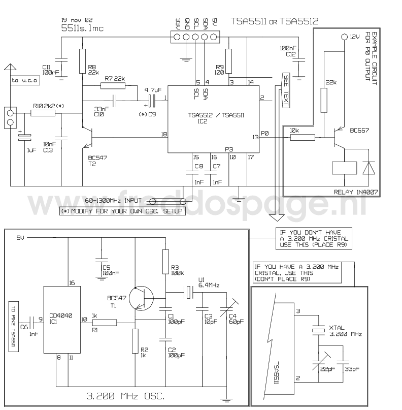

Since you got this stuff off the internet, I'd like to ask a few more questions, and offer some additional observations.
Did you get the datashett for the TSA5511?
Do you understand how the part works?
The minimum input frequency is 64 MHz. -- not 0!
The drawing does not indicate the reference frequency you are using. If you are using a 3.2 MHz. crystal, then your reference frequency is 6250 Hz., and your minimum frequency step will be 50 Kz. To increase the frequency by 1 Mhz., you need to increase the value of the divisor by twenty(20).
In order for the device to control the VFO via pins PD and UD you need to figure out what the divisor should be.
For 440 MHz. you would apply the fixed divisor of 8 to get 55 Mhz. Now you ask what divisor should I apply to 55 Mhz. to ge the reference frequency of 6250 Hz., and the answer is 8800 decimal. This number must be sent over the I2C port as part of a three byte transaction. This number is obviously bigger than one byte, so no one byte quantity can work at that frequency.
For 470 MHz. you would apply the fixed divisor of 8 to get 58.75 Mhz. Now you ask what divisor will divide 58.75 Mhz. down to 6250 Hz., and the answer is 9400 decimal.
To cover that band takes 600 steps [8800..9400] and surprise surprise
(470 - 440)/600 = 0.05 Mhz = 50 kHz. = 50000 Hz.
Isn't that amazing!
In order to completely program the part you need to send a total of five bytes including the address. It appears that you are only sending three including the address, and relying on its default behavior for the rest. To rely on default behavior is really a very poor idea. Would you program a PIC without giving the configuration word a value?

Well OK, from your initial post I thought you were trying to control a VCO from DC(0 frequency) to 255 MHz. This was a mistaken impression on my part. It still does not explain what address byte is written to the I2C port along with the values of rhi and rlow, which I'm guessing correspond to a divisor value. How the values of rhi and rlow are established is beyond me at the moment, but I know what they have to be for 440-470 Mhz at the RF input and a 3.2 Mhz crystal.
Are you able to capture, with a scope, the transactions on the I2C bus? This would be a great clue to what is going on.
I looked on both pages and did not see a schematic diagram on either one.
