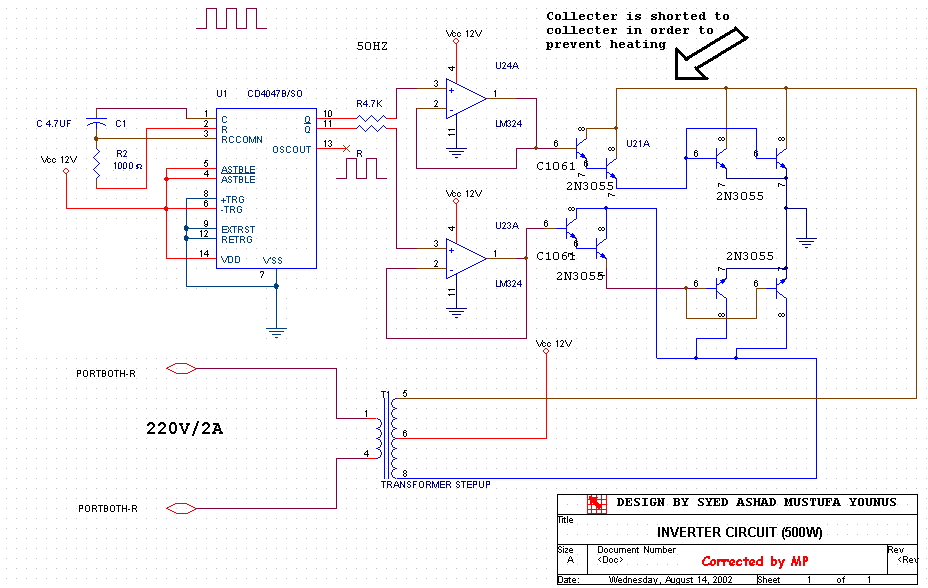

my friends made a wind turbine for generating electricity; they finally arrived to 2 wires each is 12V dc/40A.... they want to transfer it to 220V ac and the excess power they want to save it in a battery 12V/40A also... and i have to make the control...
i have many questions and i hope not to disturb you....
1) the 40A this: means that the maximum total power that can be drained by all the grid is 40A?!!

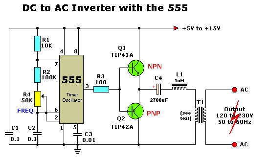

2) the attached 2 schematics containing ics is it normal to implement electronic devices in ac circuits with high current rating, there is no damage that have to be occured?!!!
3) if i have to choose between one from the attached schematics, what i have to choose?!! and why(what's the difference)

The first inverter from Electronics-Lab has a square-wave output and is full of errors.
It blows up.
I fixed it but the moderator MP deleted my version and replaced it with his mess as you can see.
The grid is a sine-wave, not a simple square-wave.
The second inverter has a very low output power and its voltage drops when it is loaded.
You don't have a way to syncronize these simple inverters with the grid so the electrical utility will not allow them to feed the grid.
You also do not have a way to prevent the grid from overloading the inverter so the inverter will instantly blow up.

But yes, 40A@12V is not a lot of power. You would need a battery bank to supply extra power when needed. It would also be good to increase the DC input voltage if you can, to increase efficiency at higher wattage.
If you have that power available fairly often I would go with the charge up some big batteries consept.
Then either run several smaller inverters independently for different loads or just go out and buy a big factory made unit to run everything. You will be time and money ahead! :)
