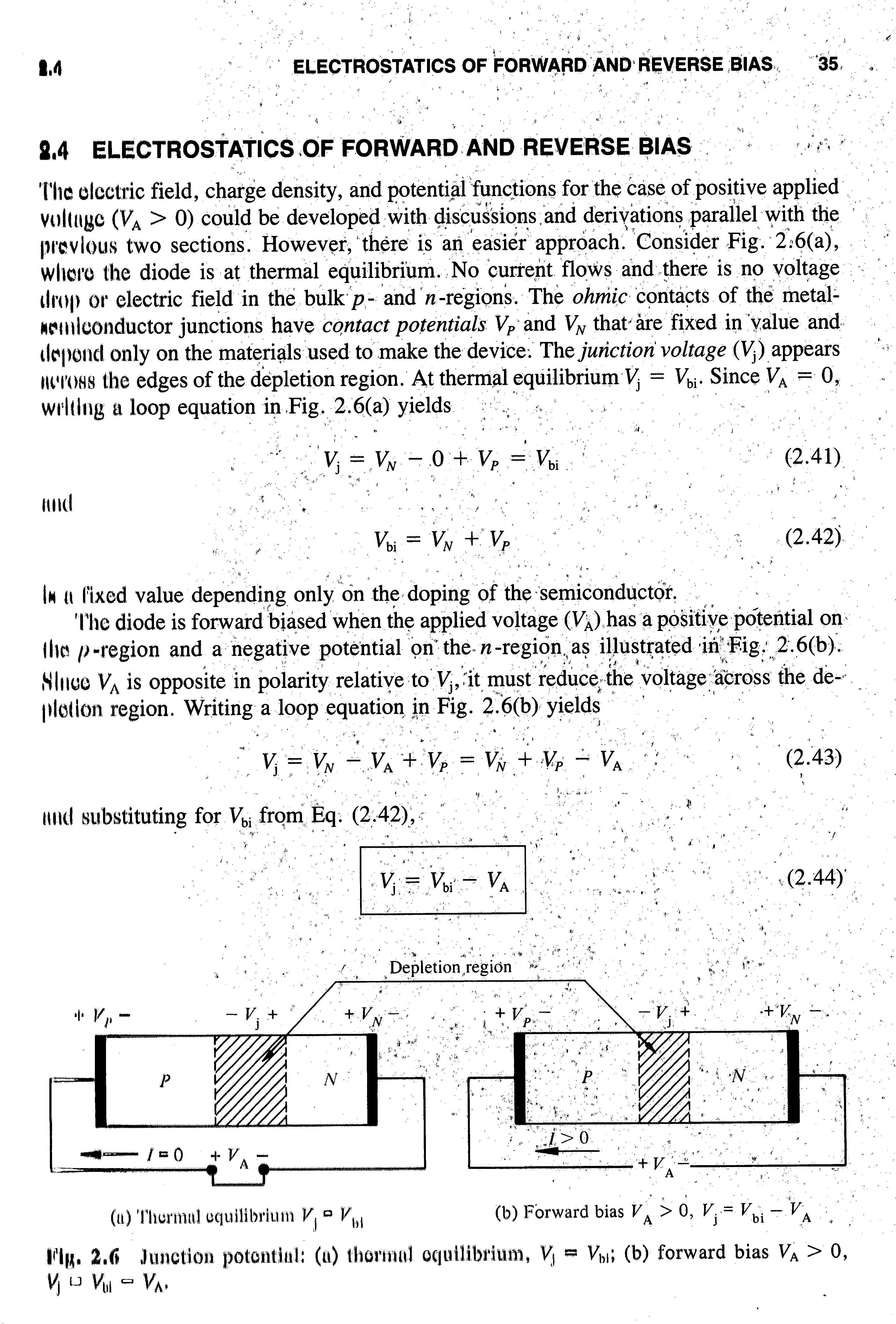

Sorry to drag this thread back from the crypt, but your question above deserved a better answer that I gave it. You asked why, when a PN junction creates a depletion region, do the ions not take electrons from the N region or holes from the P region to neturalize themselves along the PN boundary? The real answer is they are limited from doing so. Here is why as shown in the attachment. The junctions of the wires attached to the N and P material form a junction voltage called a contact potiential. At equilibrium (no external voltage applied), the barrier voltage (also called built-in voltage) is equal to the two junction voltages. So the width of the depletion region is limited by the two contact voltages. If the region because wider, then the voltages across the diode would not be zero anymore due to the barrier voltage becoming larger than the contact voltages, and a current would form when the diode was shorted. This would self-heat the diode and violate the second law of thermodynamics. As an aside, you cannot directly measure the barrier voltage because the metal microprobes would generate their own contact potiental and skew the results. I hope this answers your question in a more satisfactory way.
Ratch
