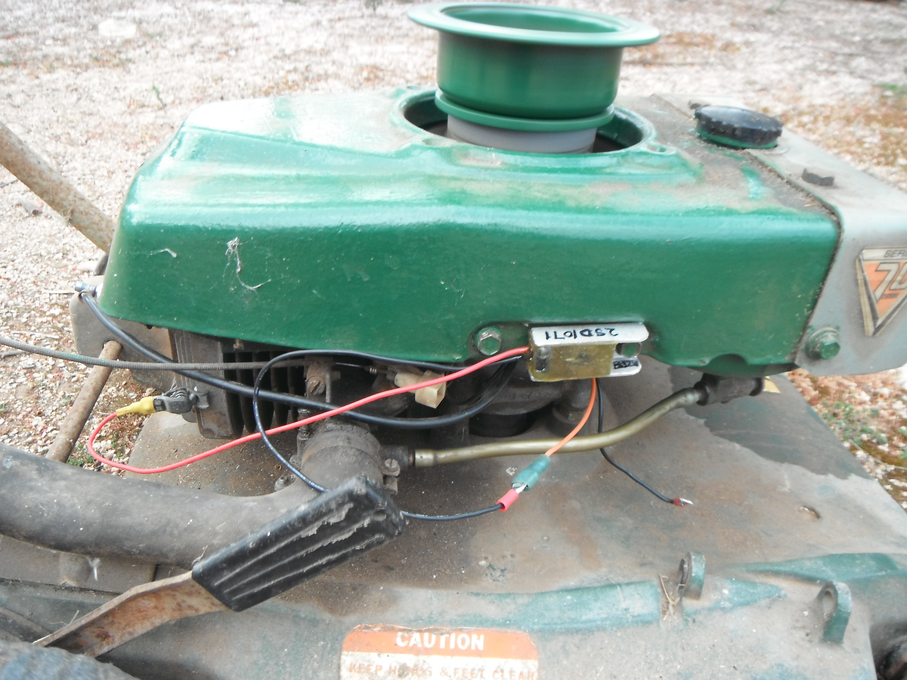

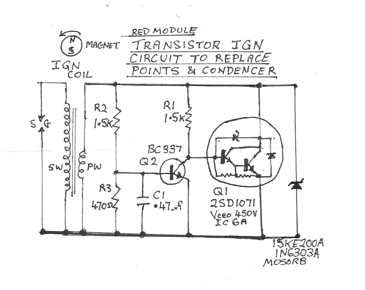

This circuit can be constructed to replace the ign points in a magneto ignition system. Ive fitted it to my Victa 2stroke mower. You just remove the points & condencer, & fit this circuit in its place on the ign coil. Depending on the polarity of the pulse from the coil, the unit may have to be connected the opposite polarity. The circuit is actualy a copy on an Atom Ign module that's no longer produced.

Awesome, thanks Debe, I more than likely have most of these parts here at the homestead, I'll definitely build this circuit and let you know how it goes, Jeff. https://www.youtube.com/user/nadingjeff
Yes the orange wire is supposed to be red. But the polarity realy depends on the polarity of the pulse from the coil, not necessarily fly wheel rotation. Its a case of try one way, if no spark try other way round. On the Victa lawn mower in the picture, the red wire goes to frame of engine. On one of my outboards its the other way round. In the circuit diagram the Red wire is to the Collector of Q1 & the Black wire is to the Emitter of Q1.

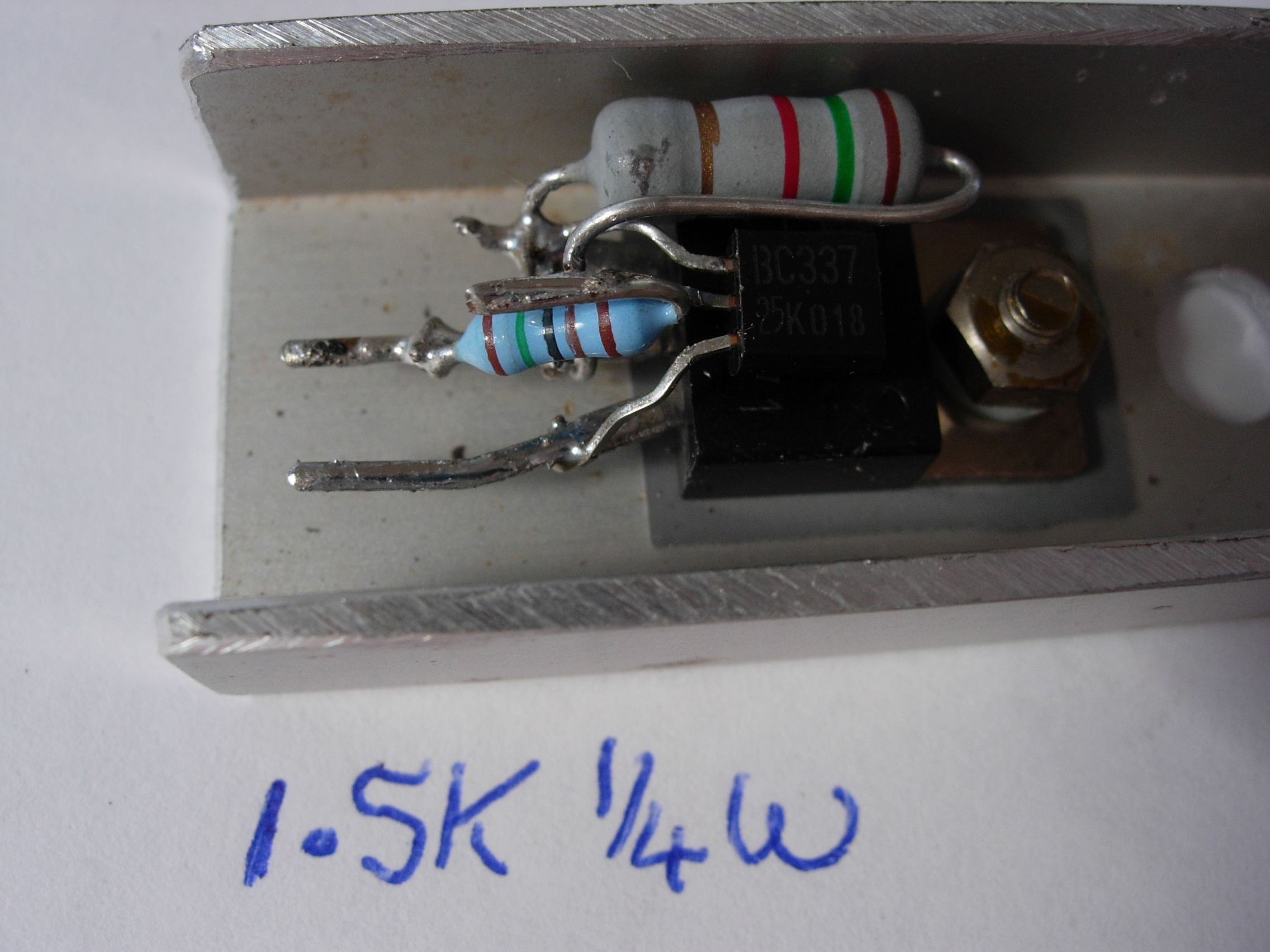

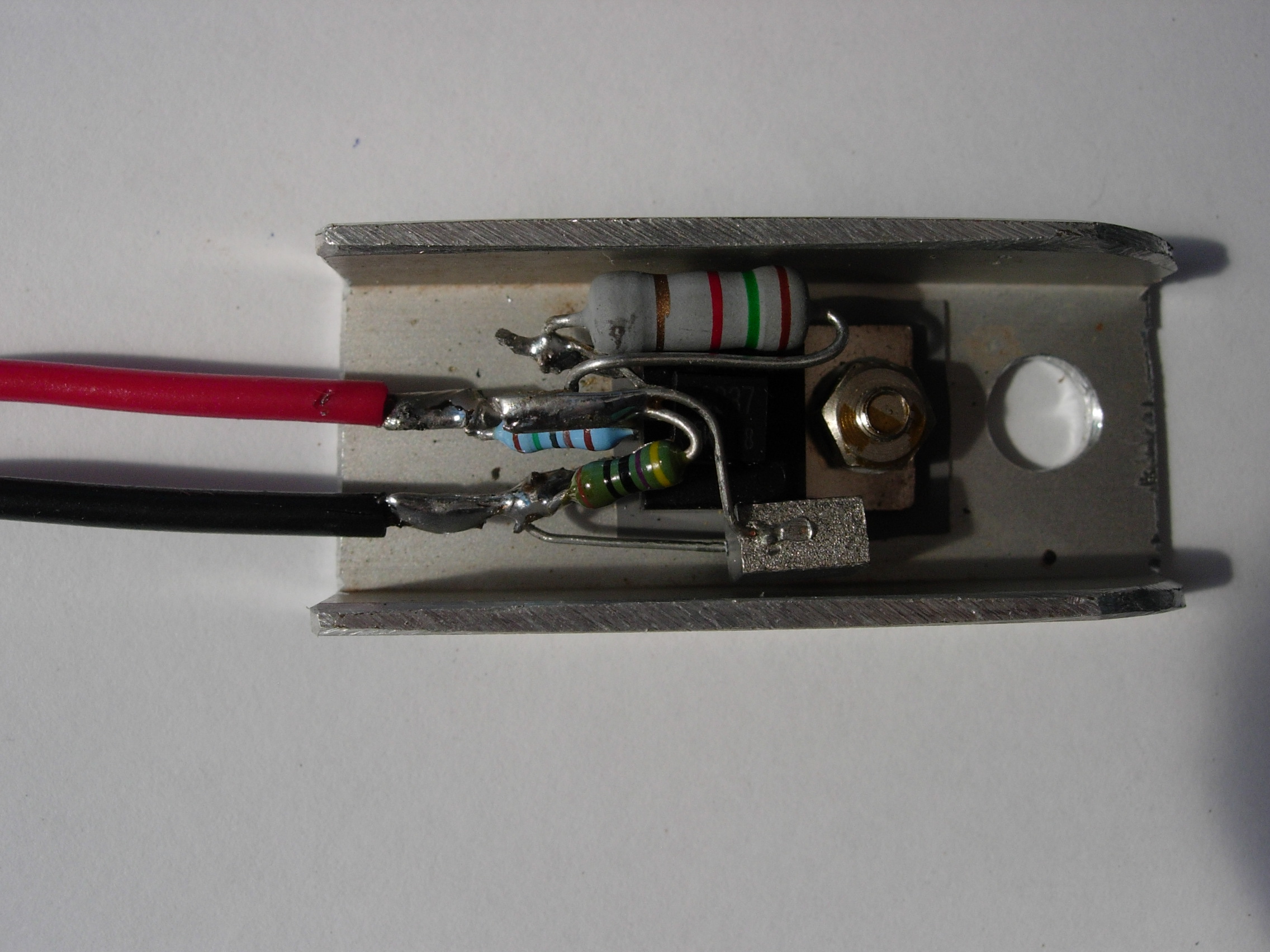

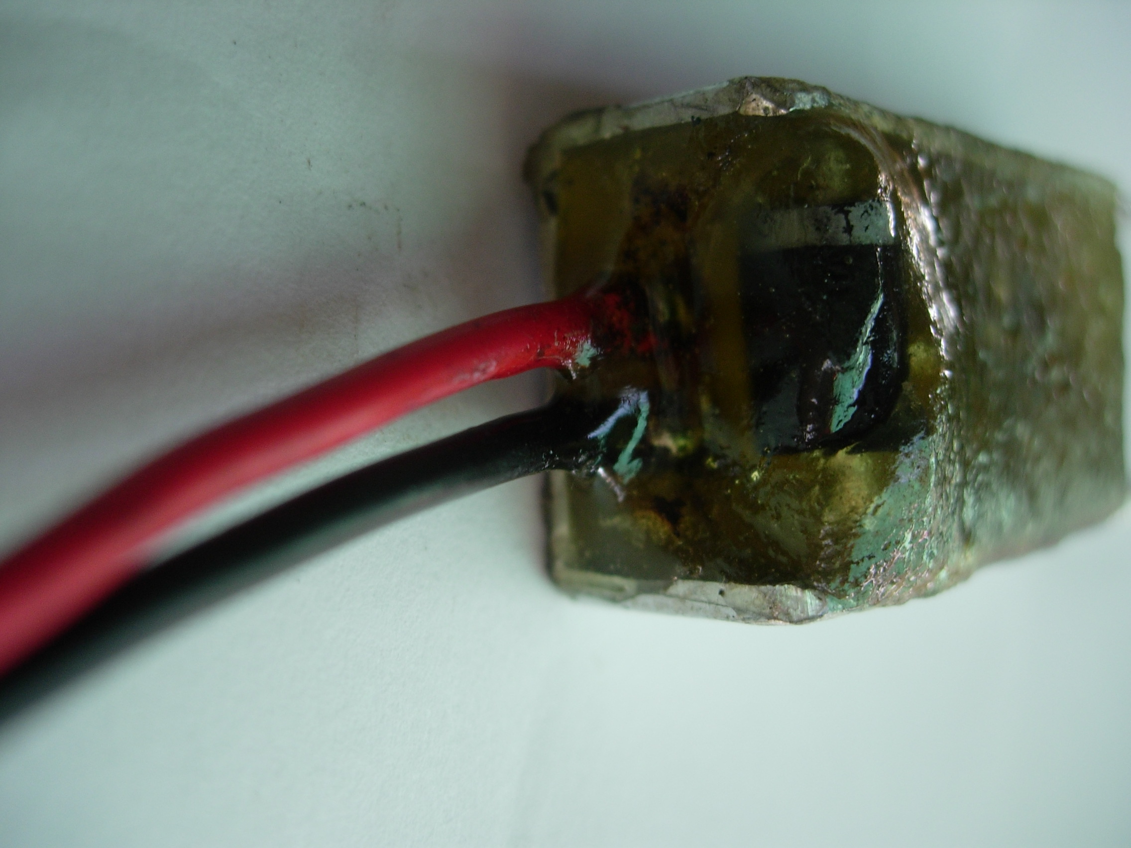

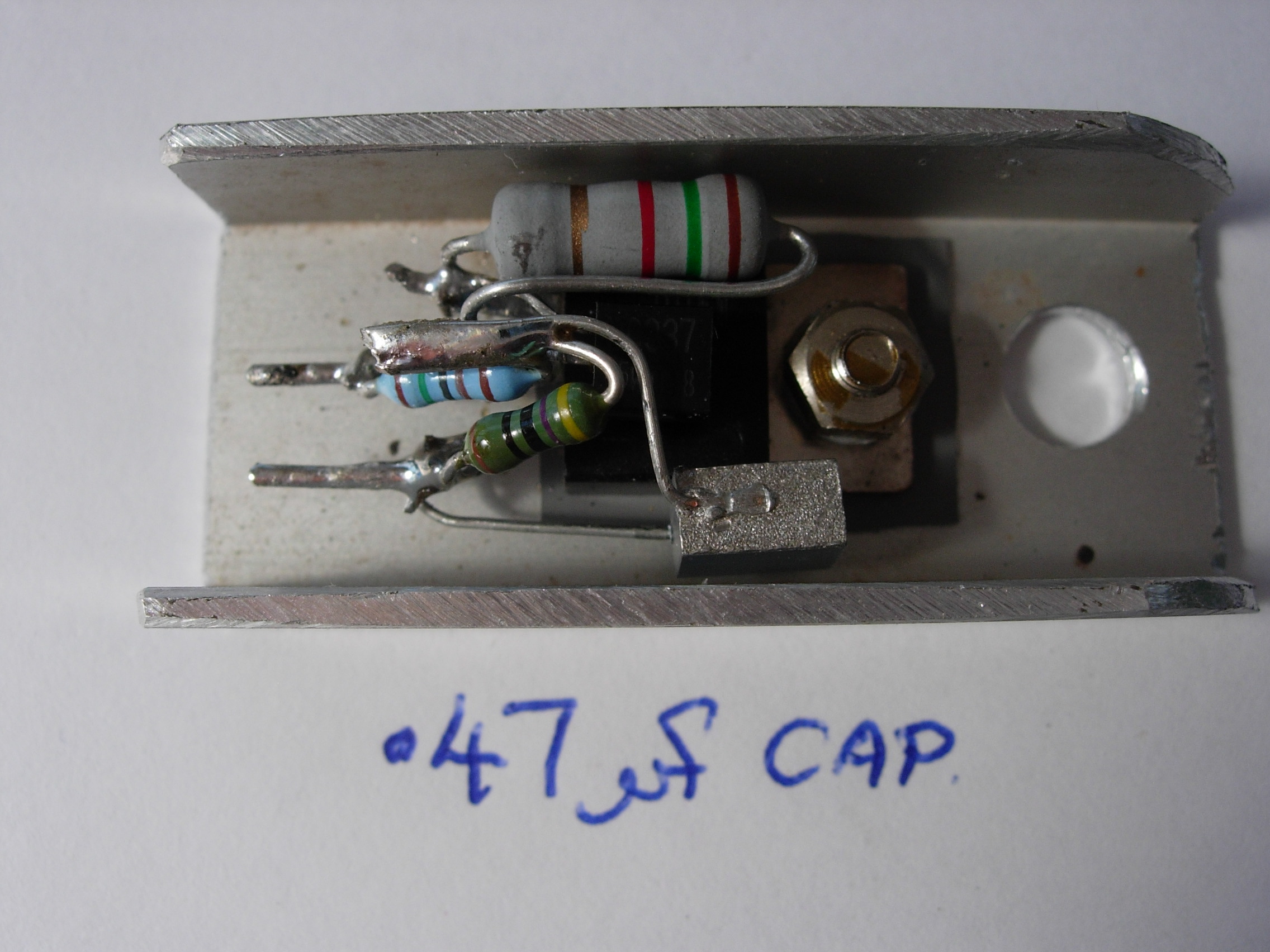

As far as I can see these are modules I pulled a part if any one wants to experiment. The resistors are deposited & trimmed on a Ceramic substrate, & the capacitor is a Chip capacitor. The circuits are allthe same but the values changed. The best success ive had is with the Red module circuit in post 7. These pictures are of the Red module dismantled.
