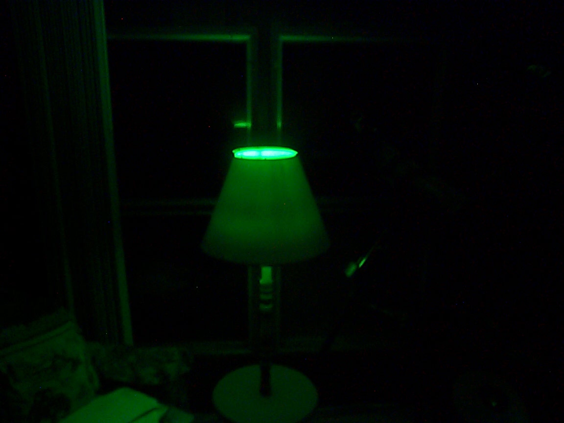

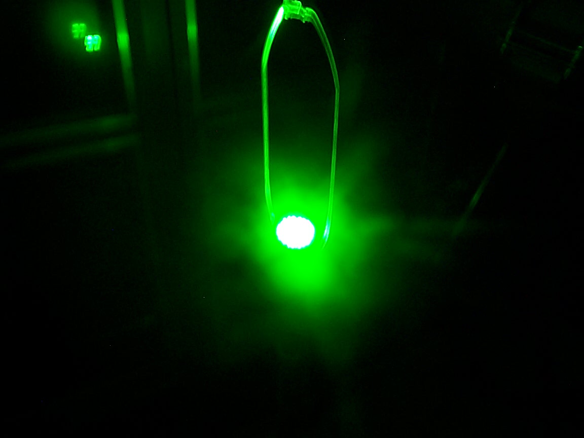

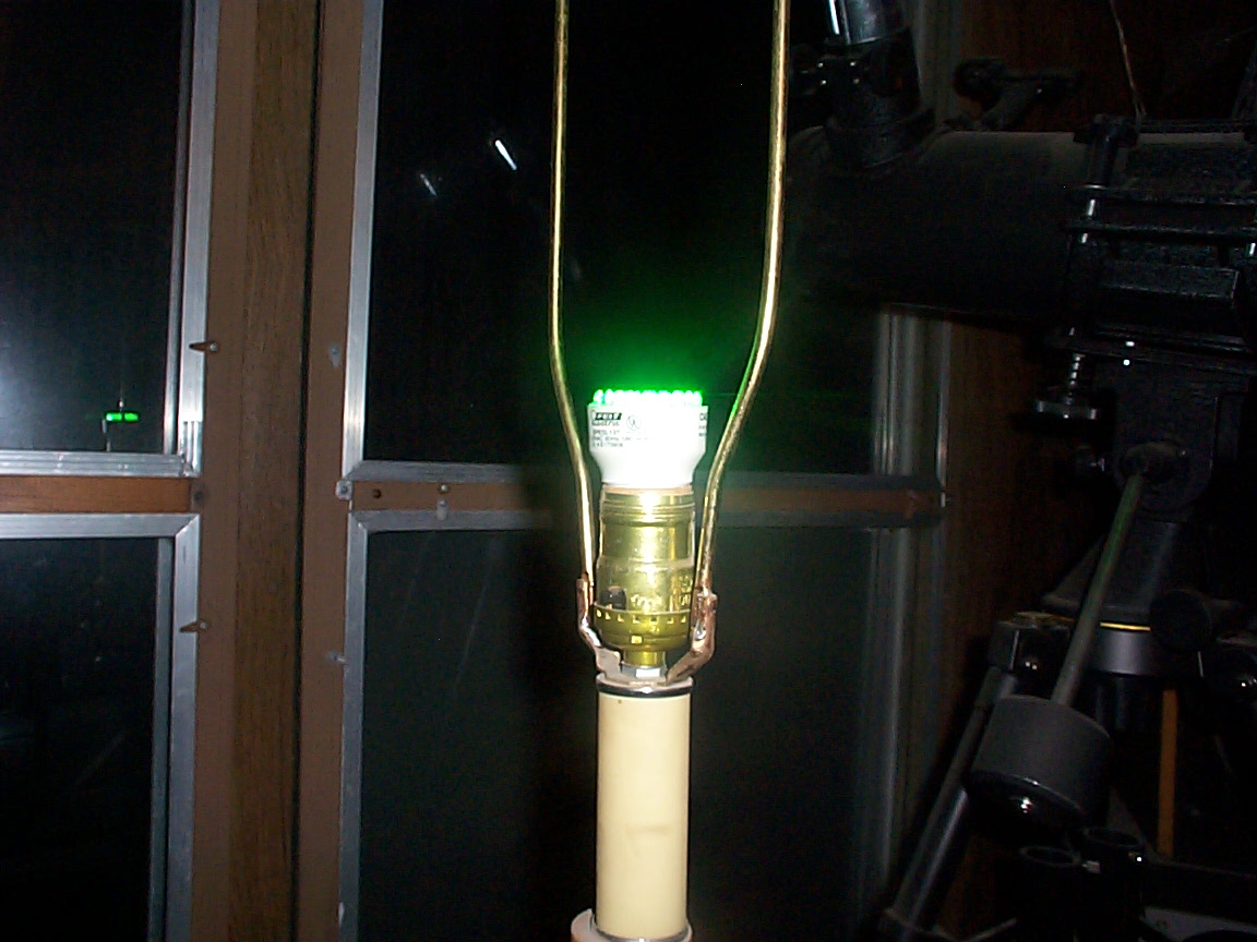

Actually this is my pointless project of the week from about 3 weeks ago.
Just thought I would show it off a little.
Its 45 super bright green 3mm LED's wired in a series and ran off a capacitive reactance current limiting power supply right from the 120 VAC line.
It does not serve any real purpose other than to be a rather unique and bright night light/conversation piece! The actual power consumption is around 3.5 watts and hopefully the life expectancy is near the estimated 100K hours that the LED's are rated for.
I just built it on an old piece of prototyping circuit board that I trimmed to fit in an old Compact fluorescent bulb base. :)
So you got any pointless projects you would like to show off? ;)

Hope you used a good cap, that's gonna go long before the LED's do.

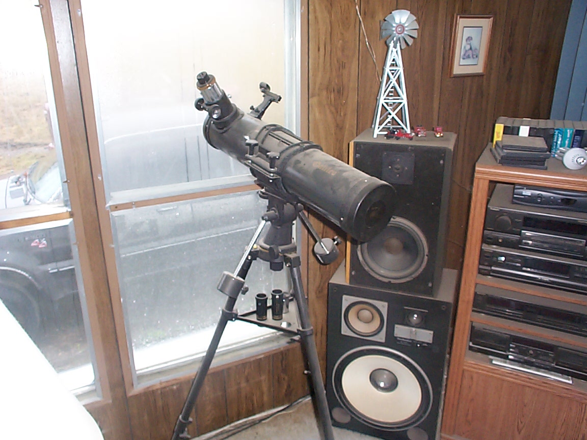

Tell me about the telescope in the backround. That Celestron or Meade? What size? What type, reflector?
Lefty
If you would've used RED leds, it would've made for proper area illumination for astro-viewing with that telescope. Green is the WORST color for night time viewing.
Lefty
My guess is it's old to begin with and is perhaps a 3"-6" reflector on a modified equatorial mount. Celestron's typically have a white or orange tube.
I will get a LED schematic posted soon.
I did Green because I had loads of ultra bright Green LED's. A red one and a blue one are on the to do list!
The telescope is a mid priced EBay unit. They call it a Galileo.
I have some suspicions that it is possibly a lower end version of one of the bigger and better brands.
I will post some pictures of it soon too! May be you guys can tell me if you think its a knock off or not. I dont know much about telescope manufacturers in general.
Most of its mounting brackets are plastic. But its actually a solid and heavy plastic.
For what I have done with it I am still very pleased with the overall performance.

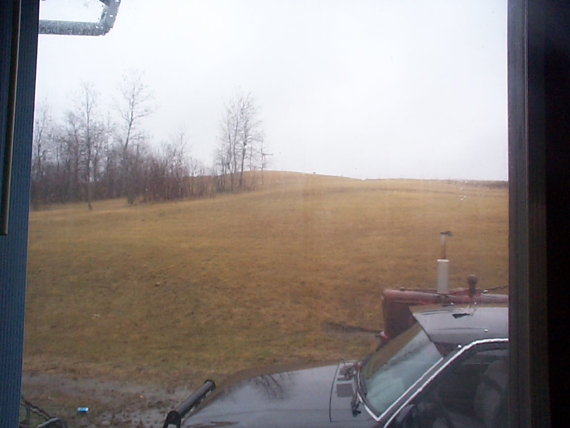

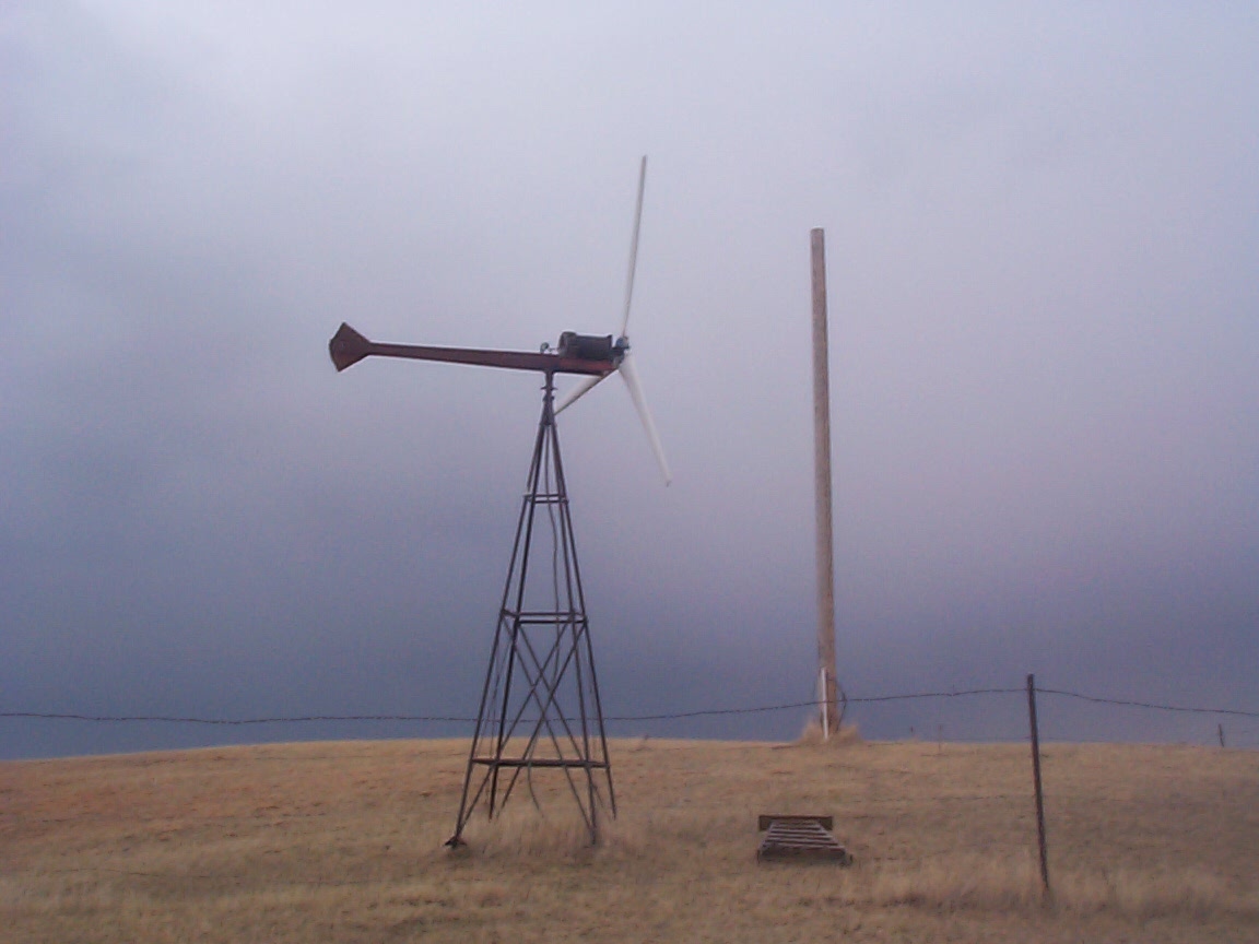

Here is the telescope in the day time and the actual view of what I do see! The most interesting daytime thing I can view is my home made wind generator.
the utility pole is where the big wind genreator unit is going and hopefully soon too! Spring and summer are often very windy here.

I am using a 120 volt 1.5 hp PM motor for the generator, and I just got done re machining a 6:1 in-line gear reducer off of a 12 hp gas engine to fit it so I can speed it up and get the full 120 VDC off of it.
The 8.5 ft blades on the one in the picture are tearing the old wind generator tower right out of the ground! And the bigger blades need to be rebalanced a little too.
Since everything is going to need to come down I figured why not make a new test unit. and move it up to the pole in the back ground for better all around wind, and thats where my underground lines come up too.
I have an above ground line between the old tower and the pole but my dads horses just love pulling it around and unhooking it! :mad:
