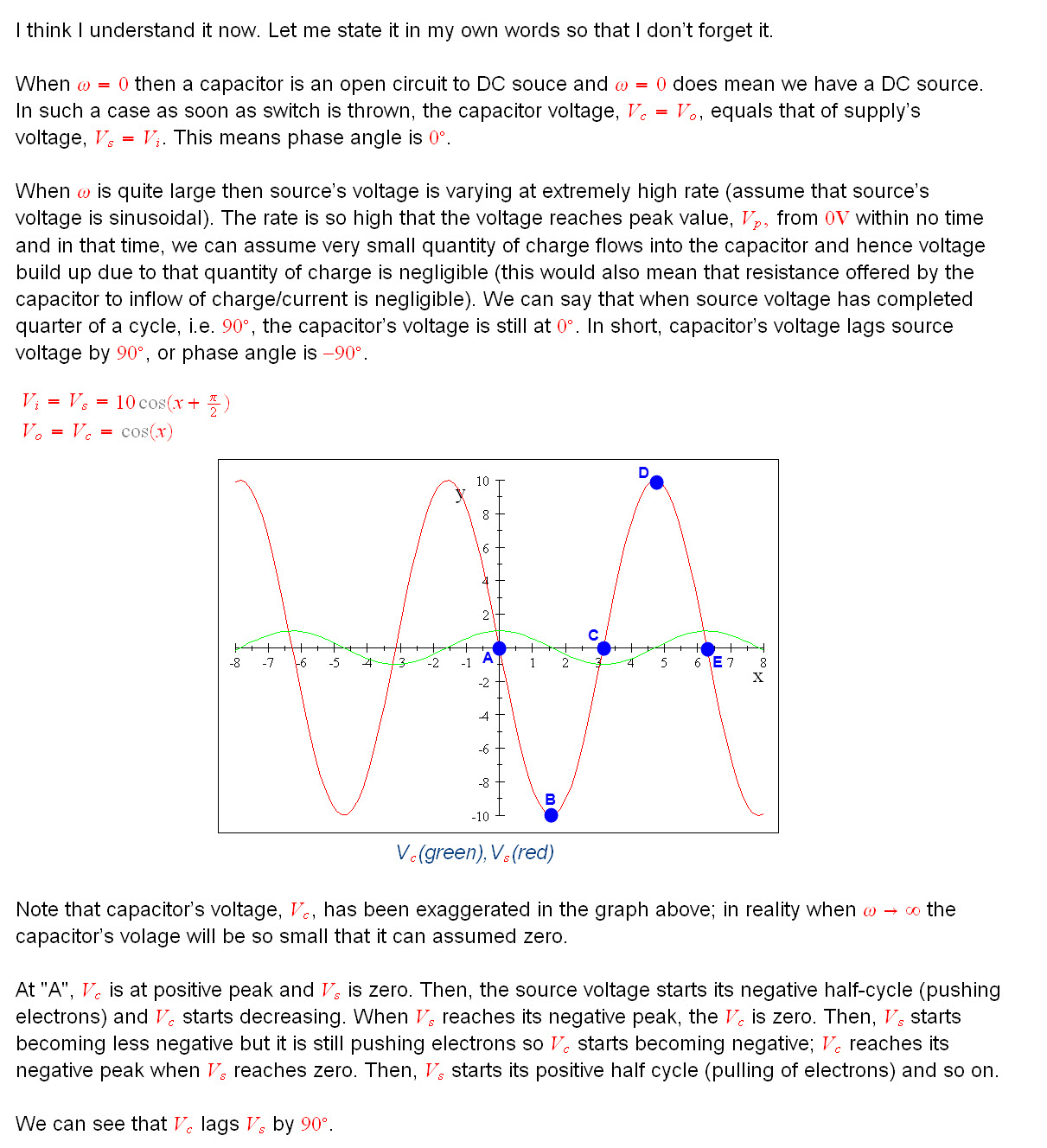

Thank you, Steve.
I think I understand it now. I believe it will do even if there are some loopholes in my understanding at the moment.
Regards
PG
There are some misconceptions in your description. For example, it is not correct that a capacitor is an open circuit and that as soon as the switch is thrown Vc=Vi. A capacitor looks like an open circuit to DC, only a long time after the switch is thrown. When the switch is first thrown, the capacitor looks like a short circuit, and current flows as the capacitor is charged up.
You are correct to stress the point, "assume that the source is sinusoidal". That is a key point. But, it's important to remember that a sinusoidal signal must exist for a long period of time, so that transient effects can die off. Throwing a switch is a transient act, so here you don't need to think about what happens right when the switch is thrown. However, a long time after the switch is thrown, your way of thinking is probably good enough to get the point.
Another way to think about it is to note that a very slow sine wave gives the capacitor sufficient time to charge and discharge in order that the cap voltage can follow the input source voltage. This creates a very small phase angle.
