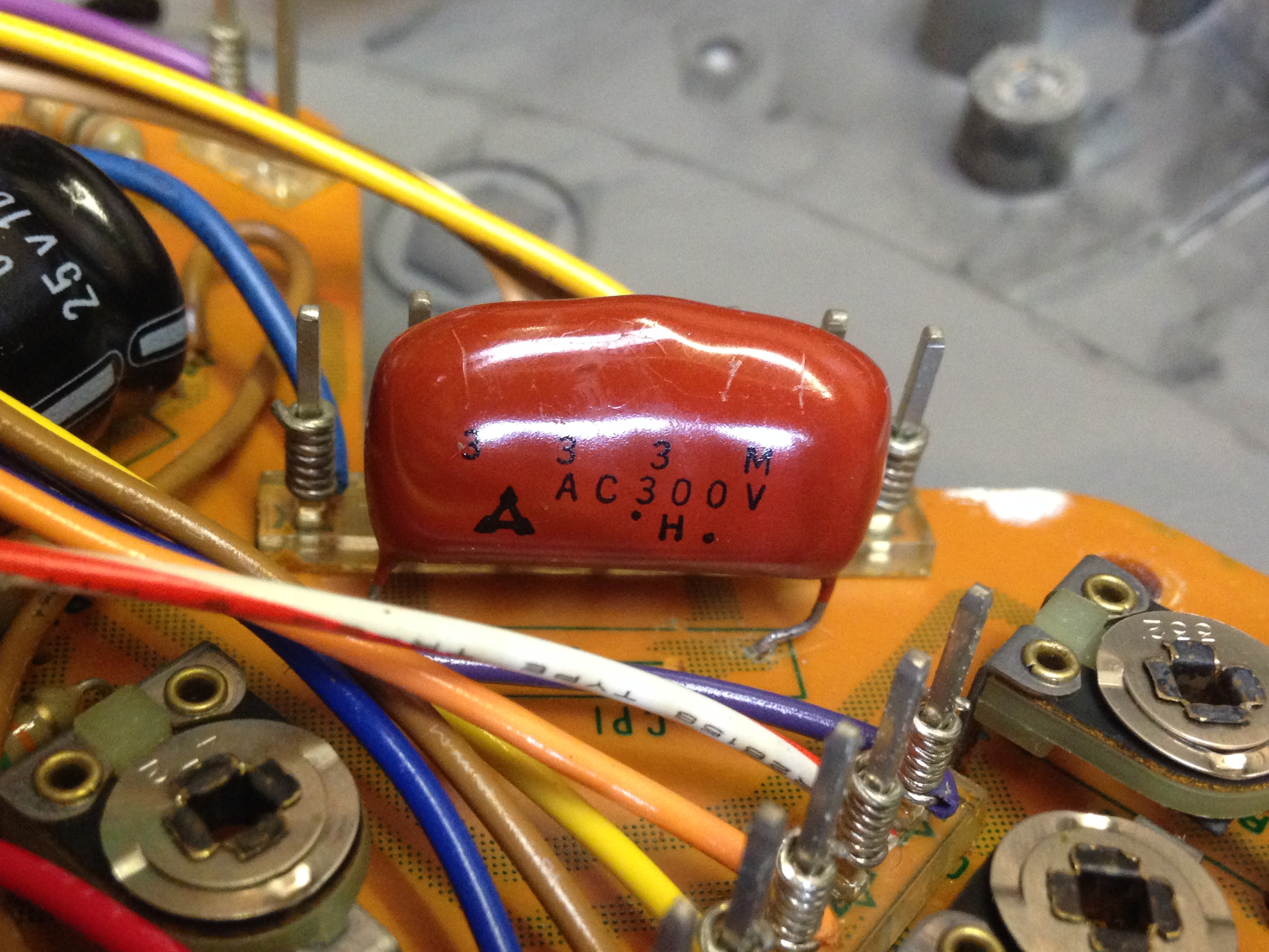

Polyester Capacitor 33nf - 300v - Pitch 23mm .
spike47
Is there another type of Cap I can use instead of this one , difficult to get that value / type and pitch ?.
Cheers
Spike
That is an AC rated capacitor. You could use a higher voltage rating capacitor, or possibly one that is a bit more in capacitance value, possibly 39 or 47nF.
Based on your picture, there is no visible evidence that cap is bad. What makes you thing that it is?

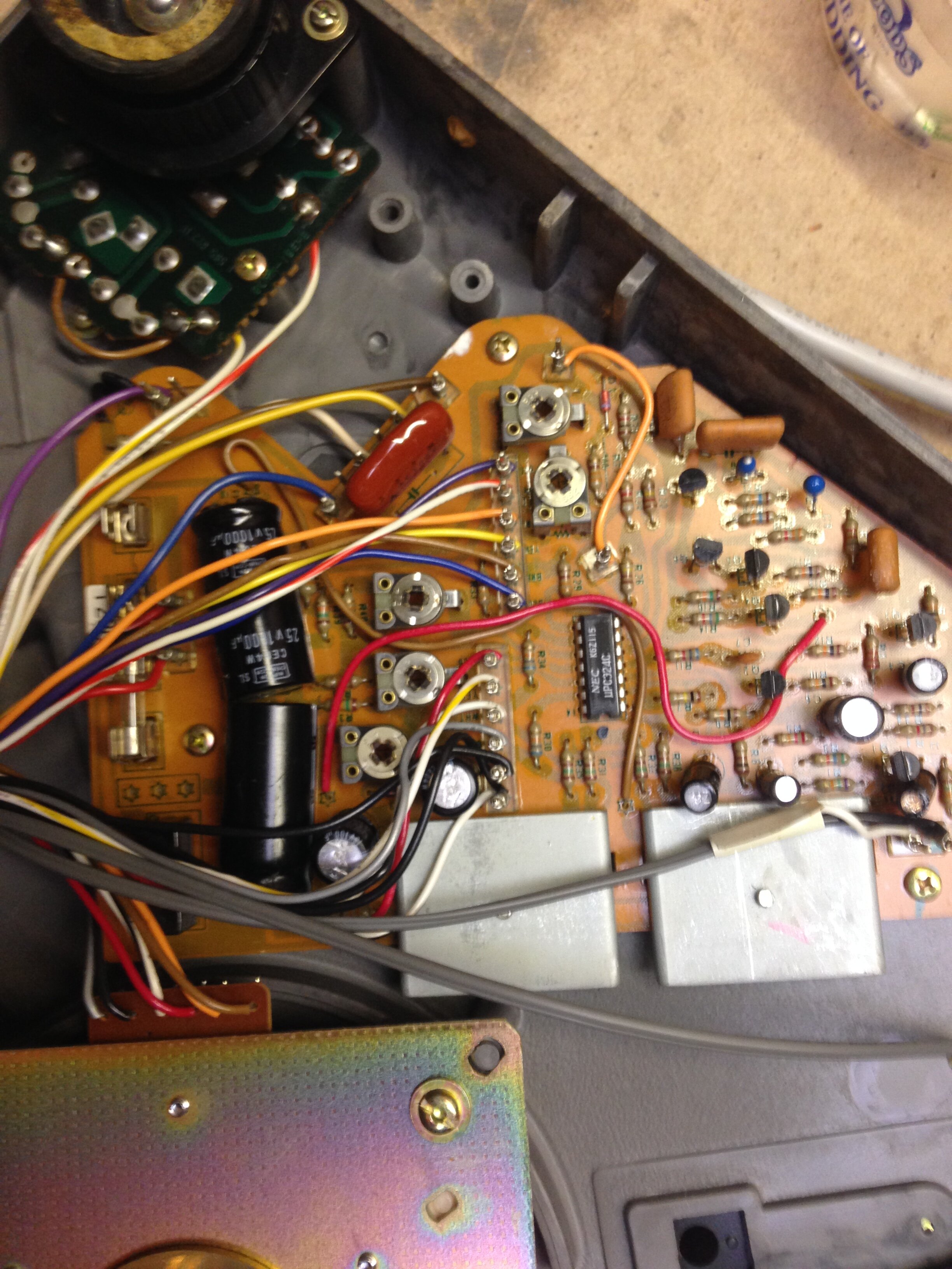

Hi
Thanks for your reply, it is off a Sony PS11 Turntable, the platter would not self start , just give it a nudge and it will run ok , so I thought it might be a Cap problem , so I took out the 3 large Caps n the board, 2x Electrolyte and 1x Polyester !( as in the picture posted) the 2xElectrolyte tested ok, but the 1x Polyester did not !,( tested the same as a Electrolyte Cap ! ).

How are you testing them?, and what do you mean by 'it tested the same as an electrolytic'?.
Certainly I wouldn't suspect that capacitor of causing a problem - but it's a fairly 'complicated' circuit (for a record player) as it's an early brush-less DC motor.
Assuming it's C12? (you didn't say) then it's in a very low voltage part of the circuit.

Have tested the caps with a Multimeter , charged the Caps on diode test, then checked voltage straight after ! .
Spike
how long do you expect a 33nF capacitor to hold charge when connected to a 10Meg resistor? it will discharge in 100ms, so no surprise you don´t see the result you expect. You should test it with a meter that can measure capacitance and also ESR if possbile.

Ok Guy's
I am getting a little confused here ( easily done !) .
Can I test the Polyester Cap using a Amprobe AM 500 Multimeter , if so how do I do that test , other than the way I have said I done it ! .
cheers
Spike
Thanks for your reply, not sure what you mean " Connected to a 10Meg resistor " .
Bascially all multimeter have internal load resistance of 10Meg ohms, so when you connect your meter to enything you load the voltage you are measuring with that resistance. And in case of that tiny capacitance it discharges so quickly that you can´t even see the result.
Ah, ok understand now , so it looks like I am going to have to purchase another meter to test that ! , I don't suppose there is another way to test without me having to buy another meter is there ? .

You can't really test capacitors with a multimeter - but you don't repair things by randomly trying to test components - I wouldn't have even looked at that 33nF.
Hi
Thanks again for your replies , if you have little knowledge like me, it is sometimes the only way for me to find out what the problem is by elimination ! .
cheers
Spike
Hi
Generally it never helps, and causing more problems than you started with.
And unless you can test parts correctly, you're not achieving anything - and the only real way is by substitution with a known good part.
