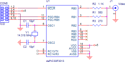

I was working on a dsPIC video generator for NTSC, this PIC can run at 120MHz (8x PLL)

I noticed the LC tank to detune the crystal. Speaking of Teletext that's what I was hoping to build with the dsPIC... Maybe add an SPI SRAM...

The code that that chip uses is very clever, to get that sort of resolution out of a 9MHz instruction clock is just amazing.
To do the same on a GLCD would be really trivial by comparison.
