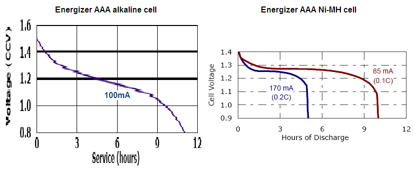

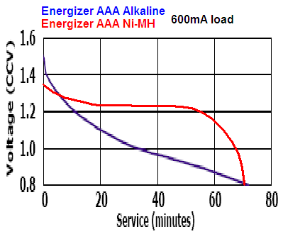

audioguru. NiMh's start high, but their nominal voltage even slightly discharged is only 1.2 volts per cell.
The alkaline battery voltage keeps dropping until soon it is less than the fairly flat voltage from Ni-MH battery. Then the voltage from the Ni-MH battery is higher than the alkaline battery for most of the discharge.
It is more obvious when the current is higher.

Those are AAAs What about AAs or Ds under the same load?

AA alkaline cells have 2.5 times the capacity of AAA alkaline cells.
AA Ni-MH cells have almost 3 times the capacity of AAA Ni-MH cells because they weigh almost 3 times more.
