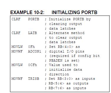

Hi, writing to PORT or LAT is the same thing as can be seen from the data sheet picture attached here. A Write on a PORTx or a LATx results in changing the output of the port pin physically ( if the pin is configured as an output). A read however on the LATx register will result in the last written value and not the actual logic present on the port pin. Read description in 10.1 of datasheet.
Now about you query regarding the voltage on pins, the voltage on the last nibble of PORTB is near 0 because you have configured them as outputs and are setting them LOW. For the 0.32 volts, have you got a 0.1u capacitor between the power lines? For the upper nibble part, they can not be written to since they have been configured as inputs, and also you have not turned on the pull ups. Its just an arbitrary voltage.
Have you configured them as digital pins for them to be used for the keypad?

It can be done using the ADCON1 register but you should keep in mind that you just cant make a pin digital and analog at your desire, The AD converter module refers to pins as AN0, AN1 and so on i-e channel 0, channel1 which in fact are not necessarily related to the pins(in order from PortA onwards and in numbers there off). For making all pins digital except A0, you have written correctly in the program snippet you gave above.
ADCON1=0x0E
Page 226 of Datasheet for this.
PS: PORTB is not all digital on Power UP.
