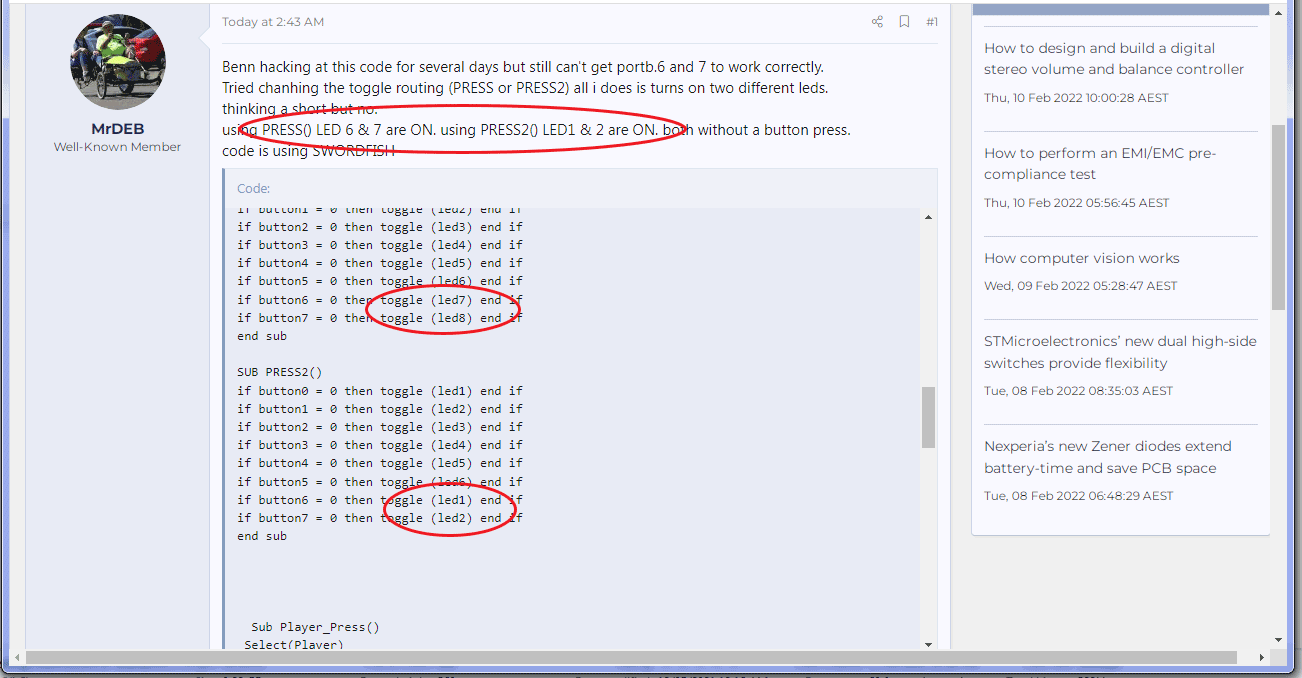

Benn hacking at this code for several days but still can't get portb.6 and 7 to work correctly.
Tried chanhing the toggle routing (PRESS or PRESS2) all i does is turns on two different leds.
thinking a short but no.
using PRESS() LED 6 & 7 are ON. using PRESS2() LED1 & 2 are ON. both without a button press.
code is using SWORDFISH

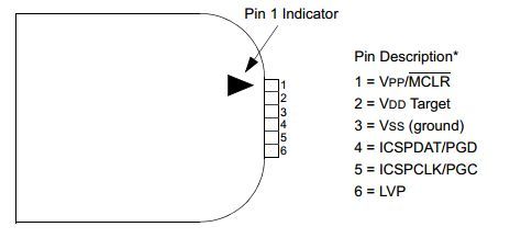

yes pickit2 is connected.
As I mentined IF I run the board with only sub PRESS() then LED7 and LED8 come ON.
If I run the board with only PRESS2() then LED1 and LED2 come ON.
No I only run one of the subroutines. I wrote PRESS2() to verify if I had a short or?
If there was a short then subroute PRESS() or PRESS2() shouldn't make a difference.
I hope this clarifys what the board is doing.
Its my understand that B6 and B7 are only enabled when programming and when done loading the code only Vcc and GRD are enabled. Having the pickit2 connected shouldn't affect it?
IF the pickit2 is still connected then why does the subroute PRESS() ans PRESS2() MAKE A DIFFERENCE??
Just asking.
portb.6 and 7 ah yes, that brings back memories of checking cmcon and some other registers associated with those pins
IF the pickit2 is still connected then why...
The pickit2 has 4.7K pulldown resistors on the PGC and PGD pins, so that's going to make the RB6 and RB7 pins look like a logic low with no button pressed even though you have the internal pullups enabled.
To be seen as a logic high, the internal pullups would have to be a very low R value in order to combine with the voltage divider that gets created when the pickit2 is attached.
All of the ICSP programmers have these, although on some they're programmable.
You'll have to remove the pickit after you program the chip for those two buttons to work.
