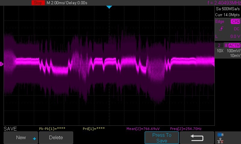

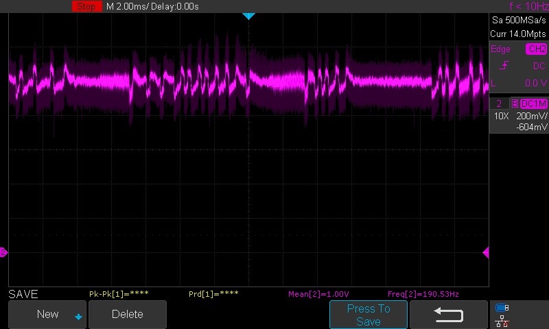

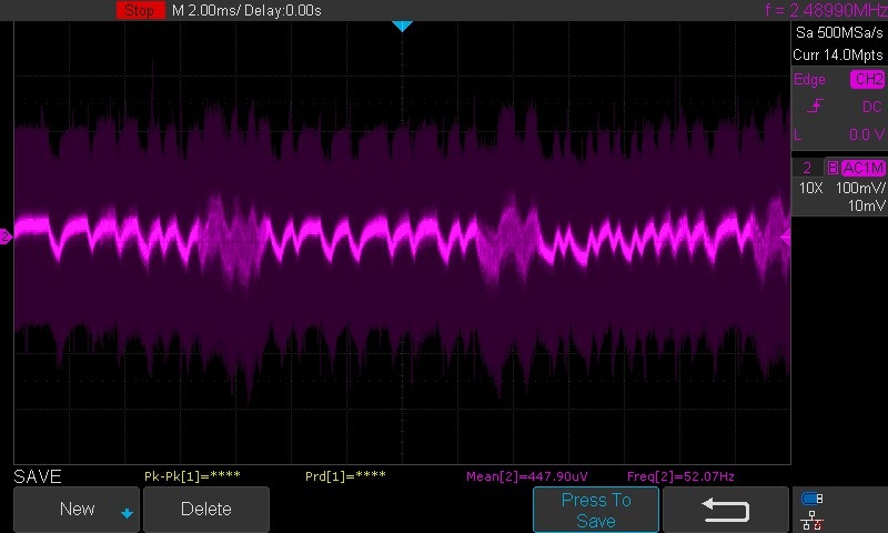

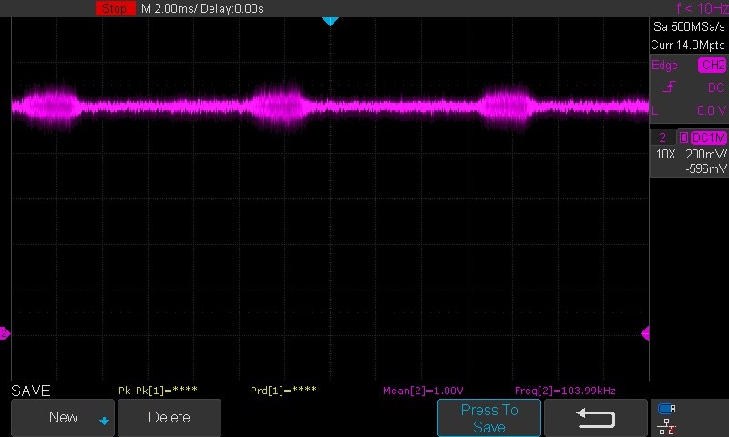

These 4 scope shots (two from circuit A of top post, and two from circuit B of top post), show how circuit B appears more stable when on constant load.
There is a scope shot of current_sensor_output and SMPS_output_on_AC_coupled for A and B cases.
I made the external current clamp fix the current to 2.53A in both cases, A and B.
The load is 15R.
Vin is 31V
As you can see, in the “A” case, there is a disturbance in the VIOUT signal of the ACS722 current sensor IC that is not there with the B case.
This is not expected. Do you know why “A” appears better than “B”?
  • Ripple at Vout of power supply on AC coupled_caps upstream of sensor _B.jpg
