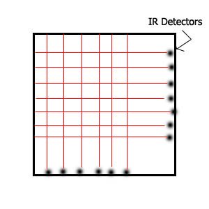

Alright, I've got a 2'x2' square "tub" with a couple inches of water in it. I'm looking for a way to detect when and where an object (such as a person's finger) penetrates the surface of the water.
So far I've thought of an array of infrared beams positioned on two sides of the tub with detectors on the other two sides (example below). The whole system would be slightly above the water. Each beam/detector combination is spaced approximately a centimeter apart so that it's near impossible to put something in between them. At this point it becomes a simple matter to determine the position from the broken beams.
Now first, is there a cheap infrared LED that is able to throw a focused beam of light 2-3 feet, or would I need to move to something like an IR laser (which from what I can tell, making an array of them would be cost prohibitive). Perhaps even a packaged array set up already?
Second, is there simply a better way to go about doing the whole thing?
Now this the first time I've ventured into anything like this, so any and all reccommendations or ideas would be great to hear.

I have little experience with LED/sensor combinations but it seems to me that if you placed light sources opposite sensors - and scanned them at the same time then there would be less need for focus, possibly allowing you to use low cost LEDs and sensors. You might also reduce the blind spots by scanning pairs that are not quite opposite each other.

What I was thinking was turn on an LED/sensor pair at the same time so that the position of the source is known - that might relieve you of some worries about beam width.
In the simplest arrangement you might think in terms of X and Y coordinates where the LEDs would be lined up exactly opposite the sensors. Maybe you'd have a 10 by 10 array - 10 LED/sensors for the X axis and 10 for the Y axis. A beam interruption on either axis would give you the position more or less directly.
You might find that some kind of diagonal pairing or multi-LED/single sensor (or the opposite) would increase the coverage. An example- if something small enough was in between pair X4 and X5 it might not be seen by either pair but if LEDX4 were scanned with SensorX5 it might see it. This is likely to be more of a software issue than a hardware issue.

As long as its just going to be someone putting their finger in the water, creating small ripples, maybe you could get some kind of sensor that senses the ripple in the water. mount 4 of these on the sides of the tub. Then feed the sensors into something that will calculate the position depending on when each sensor is activated.
