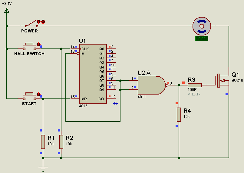

6-12v power supply connected to motor and an on switch. Motor spins a 4 1/2" "wheel". This "wheel" needs to stop at a specific point every time so an item can be removed. The problem, it needs to revolve at least 7 times after the on switch is pressed, and then stop at the same start point then immediately ready for another round.
The "Wheel" is light and restricted by friction, and only spinning at roughly 100rpm so momentum from the spinning is almost non-existant. I already tested the design with a power drill, and as soon as I pulled it away, the spinning stopped dead.
Any ideas on start-stop position switching would be greatly appreciated.
These are the ingredients for it:
- pickup device (Hall-sensor)
- decimal or BCD counter
- power stage for motor
Count the number of rotations and at the desired value deactivate the motor power stage.
Something like this?
The motor starts rotating when power is applied. After the "programmed" number of revolutions the motor stops regardless of clock inputs. When pushing START button the counter is reset and the motor starts rotating again.

Ok, I think I understand. Now, is this a sensor type that requires something placed on the shaft? Not a big deal....just don't know much about this stuff. Seems like a simple enough plan.

The motor power stage is the MosFet transistor (BUZ10) in the schematic.
2. The magnet for the sensor can be placed on any spinning surface to achieve my desired cutoff?
You can use a magnet available in toy shops and mount it a way it will pass the sensor at a close distance (1 - 2mm). Glue the magnet to the rotating part and have the sensor at a fixed position.

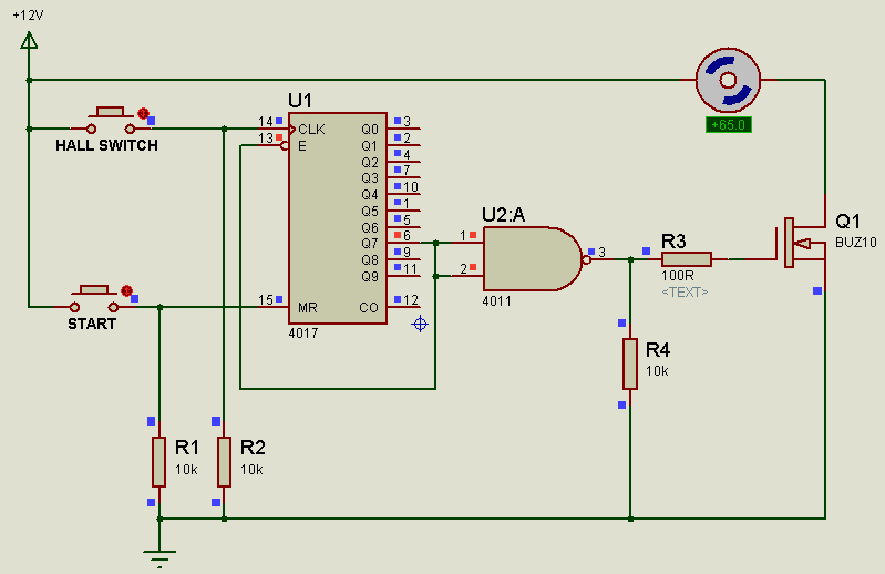

Here is a revised schematic with a power switch added to prevent motor start when power is supplied to the circuit.

Thanks Boncuk, you have been a great help! The timing I mentioned of 10 seconds is purely a goal that is achieved by the rpm factor. Perceived time of the user, if its 11, no big deal.
I will most likely go the route of the first schematic you provided. Reversing motor is not necessary, but was an option. Let me get the parts together and give this a try.
Am I correct in understanding the part U2:A is a NAND gate? If so, how is that wired into the circuit? When I did a search they came up looking like small microprocessors, which makes sense I suppose. I was planning to do this on a breadboard for now, just want to get it right.

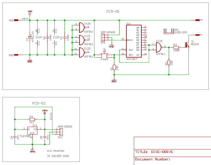

Hi Soloratov,

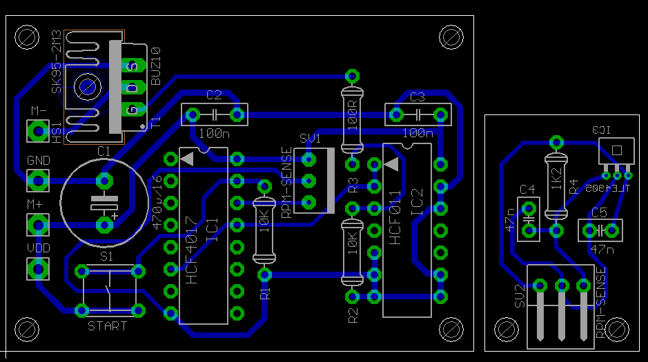

here are the full schematic and a PCB layout (2 PCBs, No1=2.125X1.525inches and No2=0.7X1.075inches) of your circuit. Both boards are completely single sided. (no wire jump)
Don't forget to mount the TLE4905 on the solder side of the PCB. The center of the tiny square within the IC outline is the center of magnetic sensitivity and must be placed exactly underneath or above the magnet.

nice job Boncuk
board layout looks good!
layout is very clear..
no weird 90D turns etc.

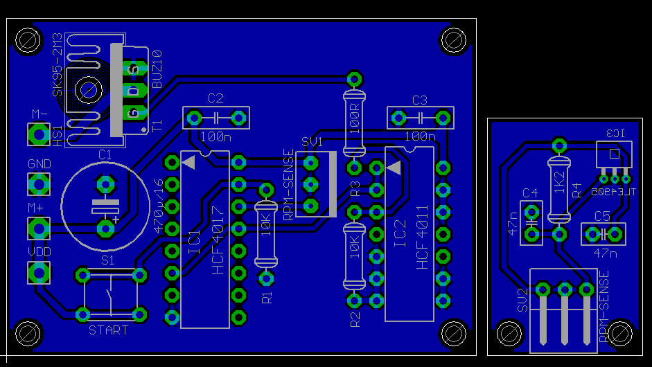

I personally have gone with the practice of filled planes. Less etching involved

Hi MrDEB,
do you mean something like that?

YES thats what I am talking about
I leave about .030 clearance around traces.
same as trace width or almost.
mostly going with .025 trace width

Hi MrDEB,
it is alright for me using .030 clearance around traces, but it's impossible between IC pins. The fill area decreases with increasing clearance. I sometimes use traces of 0.254mm to fill areas satisfactorily. When filling of e.g. ground is complete there are lots of "blank" areas not filled, thus causing areas harder to etch (because of the big surface), thereby underetching narrow traces.
For a real thorough ground fill use a trace width of 0.254mm and connect short traces from ground into the blank area. Call the short piece of trace ground and the area within it's range will be filled with ground as well, leaving "islands" only where it's impossible to fill with ground.
You might want to try filling non ground areas with any signal name you have in mind. Draw a small piece of trace and call it "fillme". Eagle will do it without any connection to some part. (Don't use duplicate names. You'll get a surprise. :))
Using that method every board is etched very precisely even with narrow traces.

Hi Soloratov,
here is a zip file including the schematic, PCB layout and BOM.
Perform "ratsnest" before printing the PCB layout.
